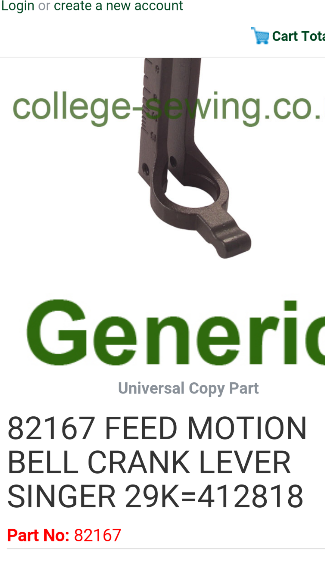

Hi people, Can anybody tell me if there is a Singer feed motion bell crank lever that will fit the Adler 30-1? It's a old black one. I broke mine!? Grrrrrr....... I was dismantling it for cleaning. I pushed to hard on the little screws that act as pivot points. Than I heard the crack. Pffff....... Now I am looking for a replacement. I haven't found a original Adler. Anyone who knows where to buy one? But I can imagine it will be very very expensive. So I was hoping for a singer replacement. The photo is just an example of the part I am looking for. Thanks in advance!!
