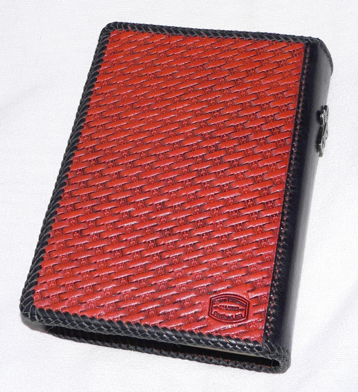

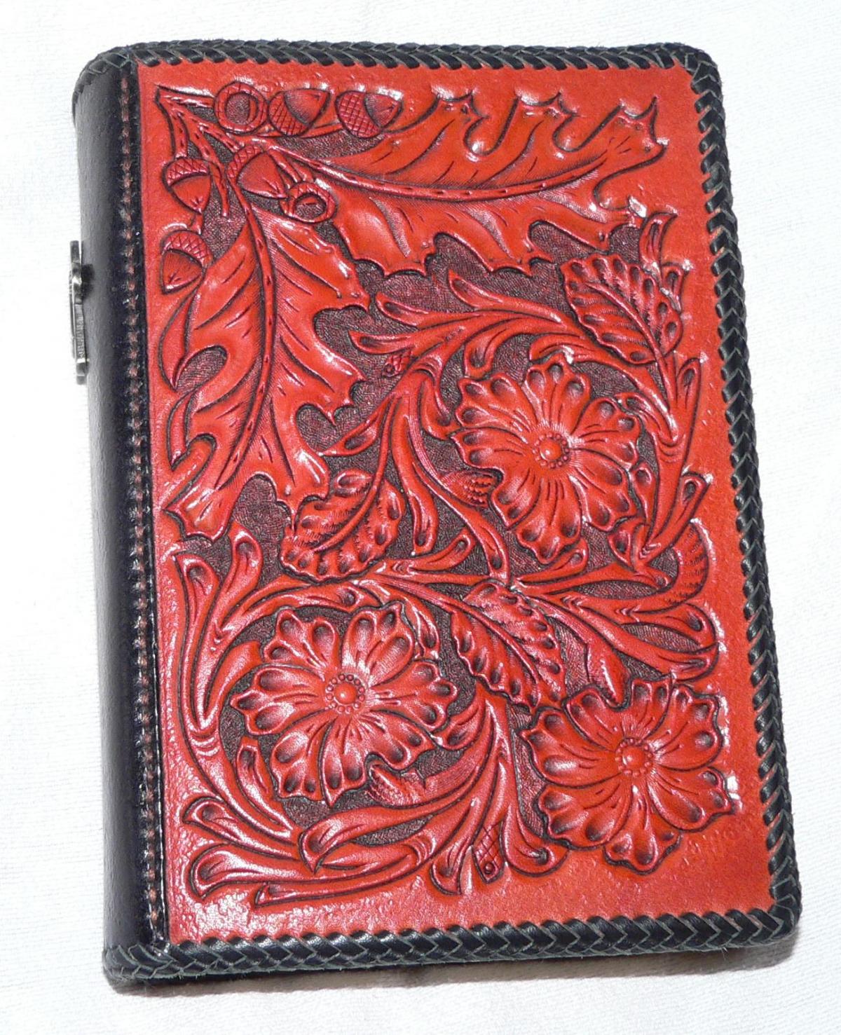

I dip dye stuff. But I also use Fiebings, have great success. The cover in the pictures was dip dyed in Fiebings, delited with alchohol. Basicly drop it in a flat pan with dye in it, swish it around, pull it out and pat dry with a towell you are not really attached to. Lave it to air dry. I personally do not use eco-flo. Aaron
