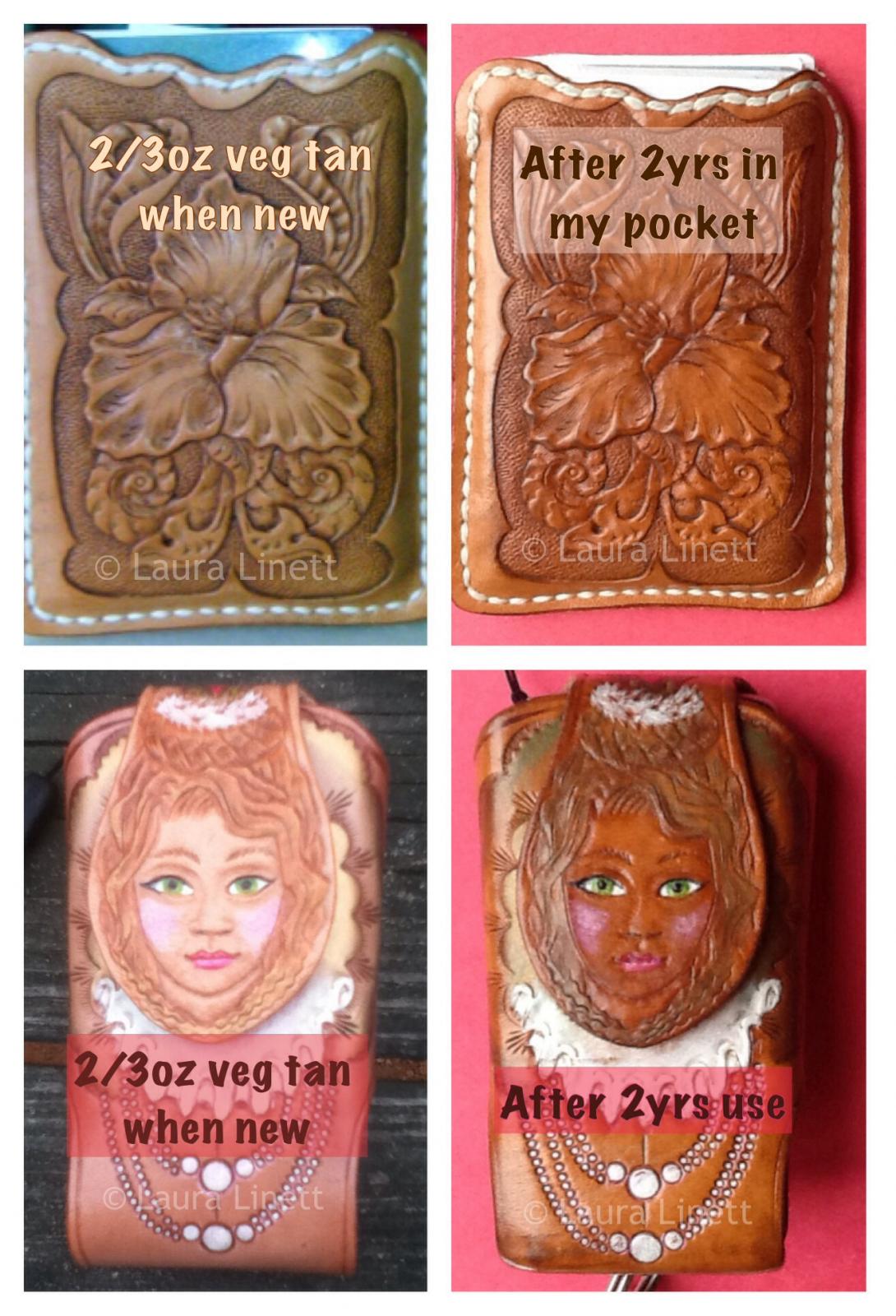

Hi There I know I posted this picture yesterday in another discussion but it seemed kind of relevant. This is my personal cell phone case I have worn on my hip for at least two years and shows what time alone can do. It has turned into that reddish color. My t shirt is usually over my phone so she has not really had that much sun exposure. I oiled it with Lexol NF which is non darkening and you can see that in her face which is the original leather color but over the years she has gone from a pale red head to a lovely African American color. I hope that doesn't sound racist. I used to do figure painting and truly appreciate all the beautiful skin tones we as humans come in. I will be curious to see how your tests go :-) On an opposite note what finishes do others use to reduce the darkening if they don't want that to happen. I have heard resolene mentioned. Any others? Cheers, Toolingaround -
Hi There Here are two pieces that I made that I carry everyday and how they look after about two years. Loads of mistakes and it was my first time saddle stitching with Al Stohlmans book in front of me but they have held up well. My girl has quite the sun tan now. Cheers, Toolingaround
