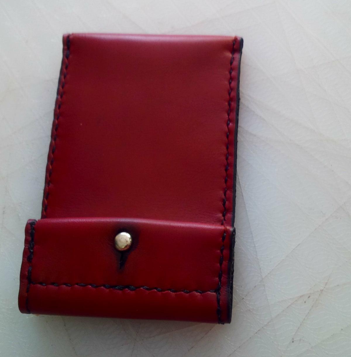

Mom says her business cards are getting ruined in her purse, so I made her this. It's about ready to polish and give to her. Leather- 3-4 Oz maroon calf. Lining: 1-2 Oz black garment. 7 spi with #69 black nylon thread, hand stitched twice. -JV474
