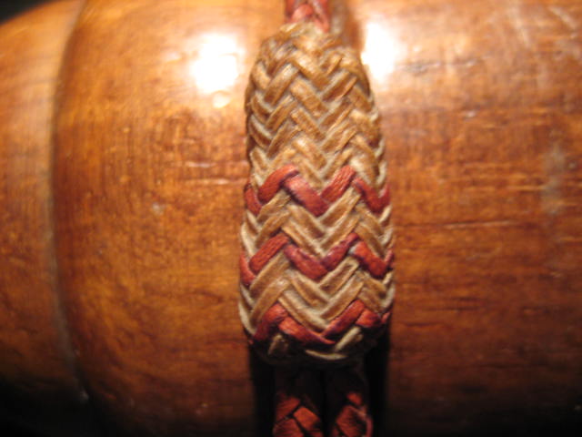

  1. Hello all Here is another bracelet I just finished. The body is 1/8" roo with the knots being out of 1/16th" rawhide. The 2nd interweave on the center knot is horsehair. Any and all comments on how I can do better are welcomed. Mike

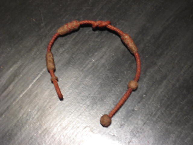

    Here's a bracelet I just finished. The body is a 8 strand braid with 1/16" roo strings. The knots are 1/32" rawhide with the two knots towards the center having a roo interweave. I thought the knots with the interweave looked pretty good to my naked eye. But then I used the macro feature on them and they don't look as good as I thought. Such is life. Any and all input welcomed Thanks Mike
