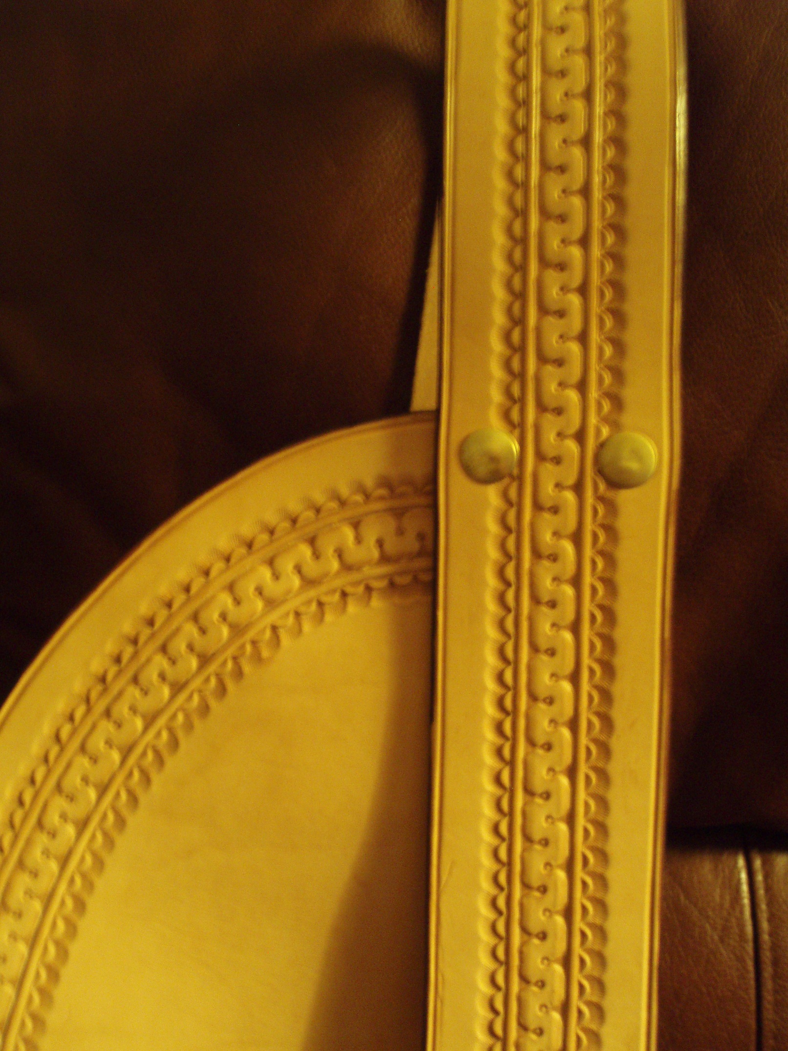

  24. I have no experience of American harness leather, but I´m using Swedish harness leather for rifle slings, stirrup leathers and such, and they take tooling very well. I put the leather in luke warm water for 5 to 10 minutes and then case it in a plastic bag. The harness leather will need more time to absorb the water than skirting and strap leather. This fender and stirrup leather is made from harness leather. / Knut
