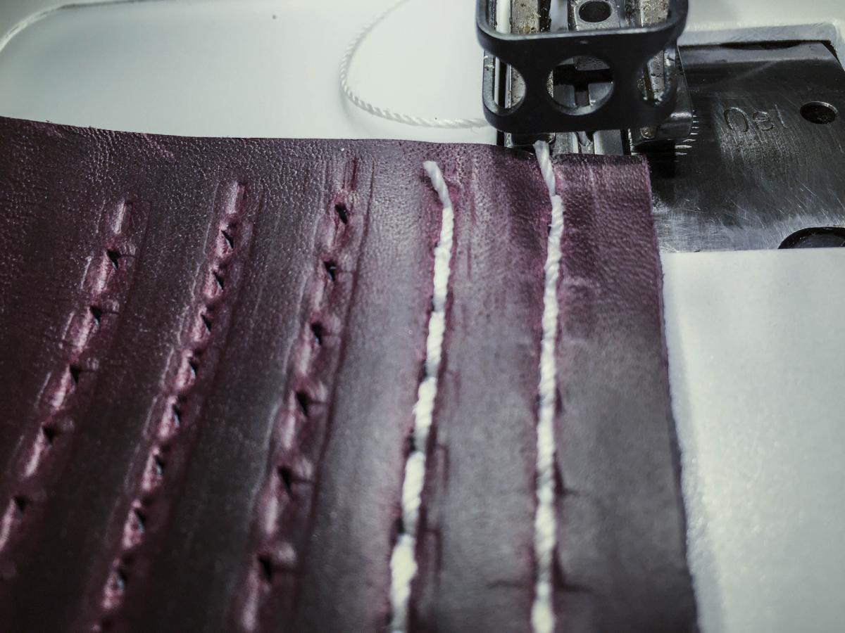

I'm glad to hear the edge guide worked out for you. I tried a few sample stitches with the different presser feet on my Adler 205. The difference is what I would call subtle, especially with 415 thread I have in my machine. I'm guessing smaller thread would lay deeper in the groove and not protrude above the leather at all. I can definitely feel the difference when I run my finger across the stitch line. The ridged stitch line feels considerably smoother. I'm not sure the pictures I took do the difference justice. In the pictures, the right (or top)-most stitch line is done with my regular presser foot without the ridge at the bottom. All the other stitch lines are done with the ridged harness presser foot from Weaver, some without thread and different stitch lengths so you can see the groove impression the ridge makes. The leather is two layers of 6oz Horween Cavalier.

Getting your stitches to perfectly align with a groove you cut ahead of time with a separate tool may be very tricky and take a lot of practice. The point of the groove is generally to have the thread not lay on top of the leather where it may get rubbed and wear more quickly. The thread laying in a groove also looks a little cleaner. I have presser feet for my Adler 205 that have a ridge at the bottom which makes a groove impression (not a cut) in the leather as you sew, and the groove is always perfectly aligned with the stitches and the thread that lies in the groove. Here are some pictures of my ridged presser feet ( One from Toledo Bob, the other from Weaver Leather, both are narrow harness feet). There are also presser feet with a slit in the front which may make it easier to line up the stitches with an existing, pre-cut groove. This one made by Kwok Hing also has a built-in guide to follow the material edge:
