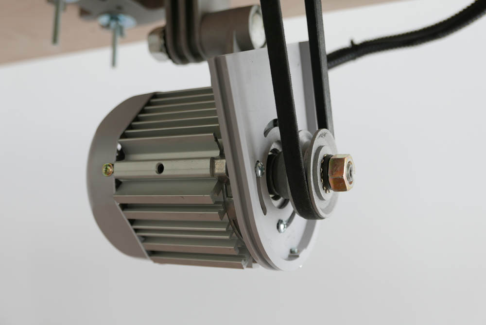

Hola Marius, The topic of servo motor variations and relative benefits deserves its own topic. From my personal experience here's what I found: There's only a handful of variations on these motors that seemingly come out of even fewer factories in China. All of them benefit from installing the smaller pulley (50mm) if you want to sew slow and leather. All of them can be combined with a speed reducer which will make them powerful enough to deal with your machine and leather. Some motors have optical sensors to translate pedal movement to speed, others have a magnetic sensor. I think the jk model has a magnetic sensor because it looks identical to my Consew branded motor. The optical sensors can be easily modified to improve pedal response - many post on that topic on YouTube and this website. No such modification is possible with magnetic sensors to my knowledge and pedal response is just okay but not great on my Consew motor. The build quality and materials vary, from plastic mounting brackets to cast aluminum parts. The JK version appears to the cast aluminum version, the ISM version appears to be plastic. The needle positioning should be accurate enough on either of them if you adjust/set the hand wheel position correctly. I tried two different servo motors with needle positioning and didn't like either of them, mainly because I set my sewing speed very slow at about a stitch per second and the needle positioning happens at normal speed. This means as I sew slowly and let go of the pedal, the motor speeds up to move the needle to next target needle position very quickly. I could not get used to the motor speeding up when I let go of the pedal and removed the needle position sensor. Personally I prefer to have good, gradual speed control at the low end and the motor to just stop exactly when I let go of the pedal. Reporting live from Hurtigruten ship MS Lofoten in the Norwegian Fjords . . . -

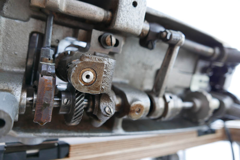

Due to the lack of nice table attachments for 335 class machines I've been working on my own design over the past few weeks. Rather than doing a one-off, I've decided to put a little more manufacturing thought into it so I can make more if I want. It's far enough along to share a few sneak peek pictures. This version attaches directly to the arm via three knobs. The board is made from bamboo, the white insert is powder coated aluminum, and the bobbin access plate is polished steel (held in place by three magnets). The knob on top of the arm uses a little cup to isolate the pivoting feed dog arm from the table to avoid binding.The whole affair installs in under a minute without tools and is surprisingly solid. I'm still fine tuning a few details and will probably make a few extras to sell after get back from vacation (watch out Trox, I'm heading to Oslo!) Here are a few pictures of the current state of development:

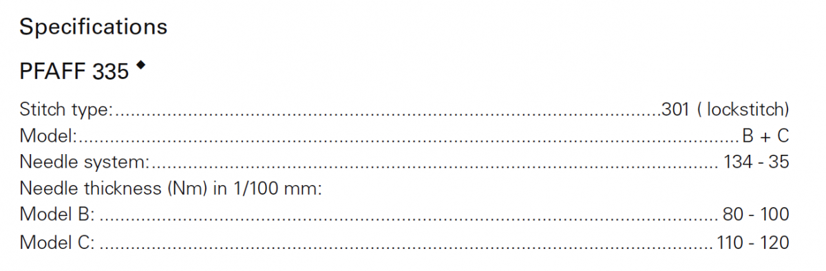

The Pfaff 335 was not designed to work with needles and thread as thick as you want to use. Even the heavier of the two Pfaff 335 versions only goes up to 120Nm needles, which is a size 19 needle and the most the machines will happily handle is perhaps 138 thread. I think neither you nor your machine will be happy with size 24 needles and 277 thread. That's 441 or 205 class territory. I have a Pfaff 335 and an Adler 205-370. The 205 picks up where the 335 leaves off, there's pretty much no overlap in their design specs. The 205 will not be happy doing fine threads, and the 335 will not be happy doing heavy threads. I'm attaching the relevant snippet from the 335 manual. -

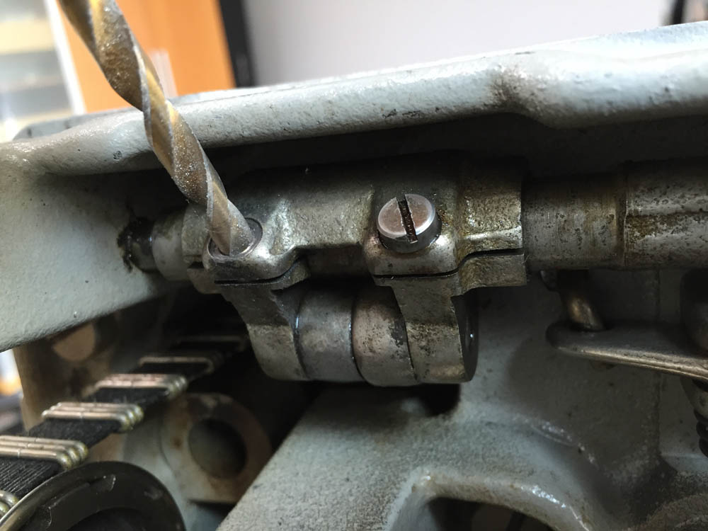

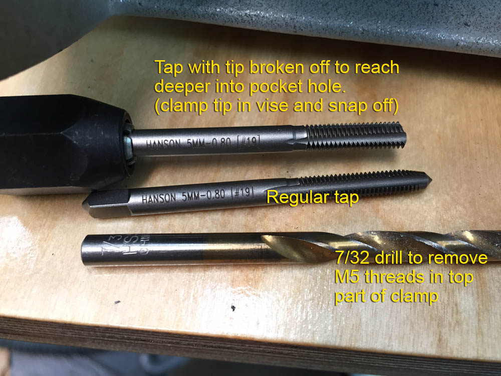

Installing a swing-down guide will involve some drilling and tapping for threads. As it happens, I did just that since my last post, haha. I just had to find out if I can install a swing-down guide (KG-867 in this case) on my Consew 225. I also wanted to get over my fear of drilling into a perfectly good machine. It survived very well, as did I. The back of my Consew 225 is pretty much identical to your Singer. The installation worked quite nicely and took me perhaps 45 minutes. I used a regular hand drill to drill the holes. I placed a vacuum hose nozzle near the drill hole to suck up the metal shavings after the first hole. The original thumb screw used to adjust how far down the guide drops was a little too big to fit the space, so I substituted a regular M6 hex head screw. I have some of these guides for sale on Ebay, check my Ebay link in my signature below if you are interested in a swing down guide. Here are some pictures that hopefully illustrate my installation steps:

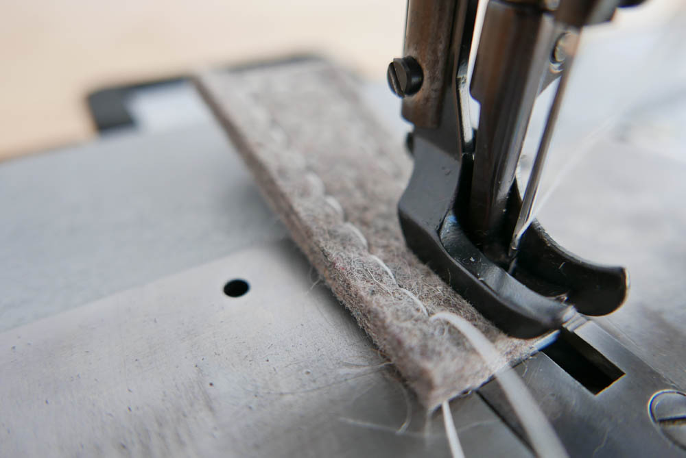

Mine is a generic presser foot I got on Ebay, not exactly sure from which seller, actually. There are similar presser feet available on Ebay right now (example 1, example 2). The thread used in the video is size 138 bonded polyester top and bottom. If you watch the video on a PC it should show superimposed captions that provide some additional details.
As to which edge guide works best for you is a bit personal preference. Some like the swing down guides, others prefer the presser feet with the built-in spring loaded edge guide or the arm/bed mounted guides. The presser feet are easy to install and relatively cheap. I've used one on my Consew 225. You can see how it works in a little video I made some time ago: https://youtu.be/Dg12IXhcqkU?t=30s The swing down guides require threaded mounting holes in a suitable location on the back of the machine. The swing down guides are easy and quick to use and offer the most flexibility with different guide attachments like rollers, straight edge, zipper guides, etc. If you post a close-up picture of the back of the machine near the foot lift lever it will be easier to tell if your machine is suitable for a swing-down guide.

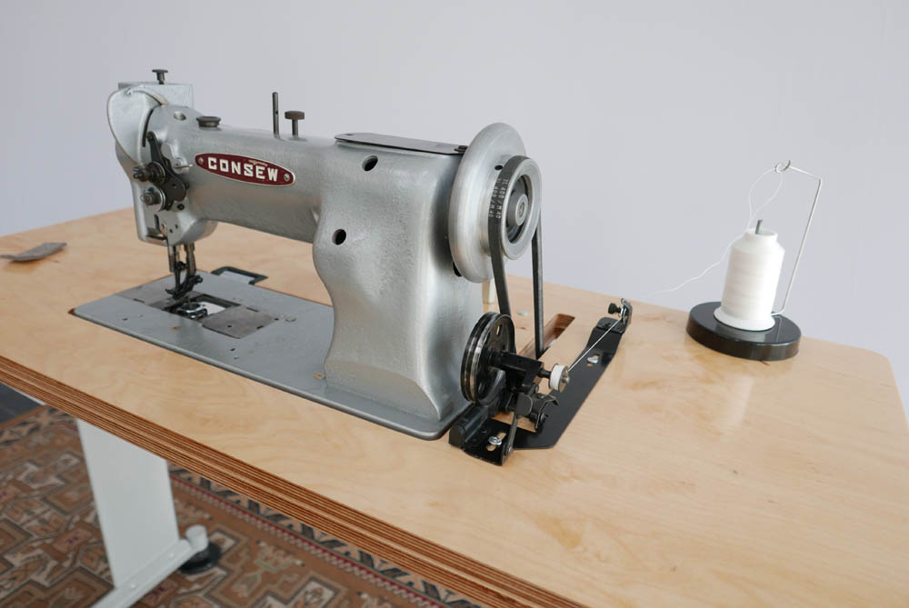

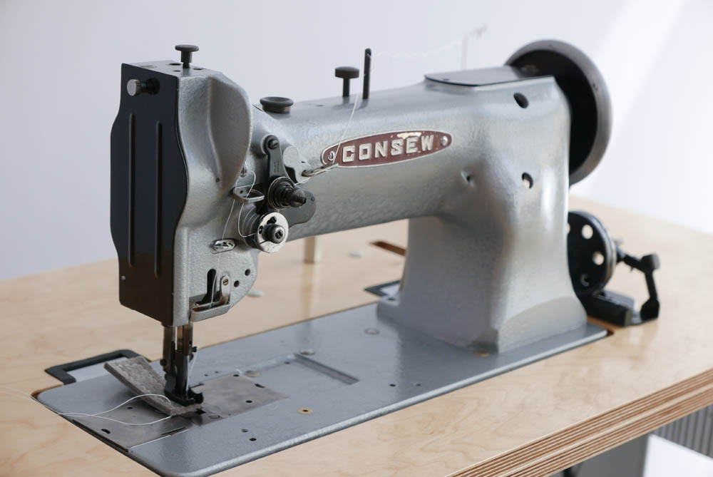

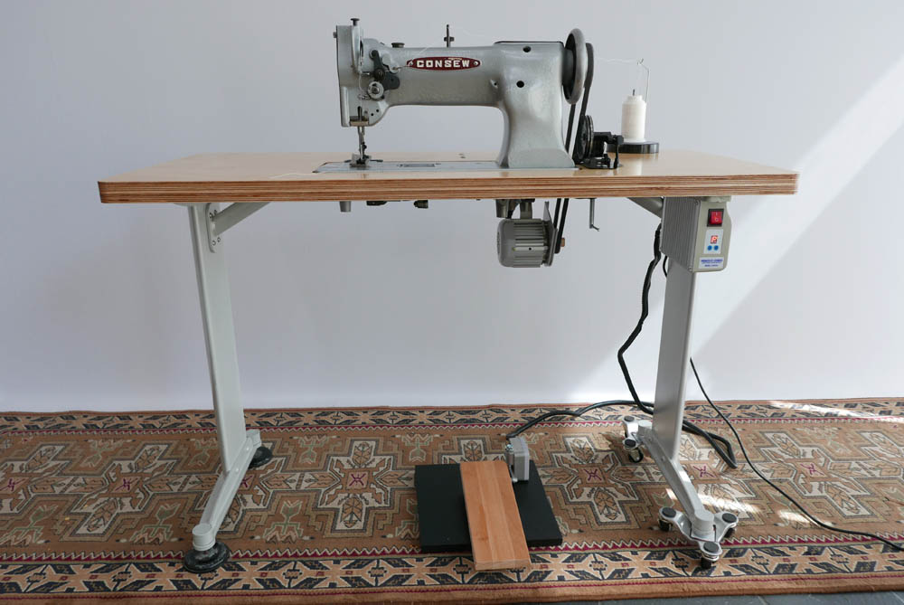

Now that I have my newly acquired Adler 67 all set up, I decided to sell my Consew 225 setup to make room. I've refurbished the machine, cleaned and oiled everything thoroughly, and adjusted the timing. It's ready to sew and looks pretty. The custom table and brand new Consew servo motor put a modern twist on this great starter machine for leatherworkers. Slowest sewing speed with this setup is about two stitched per second with nice gradual control as you ramp up the speed. It handles 138 thread with ease. My full ad is on Craigslist. $690 on CL, $650 to fellow Leatherworker.net members. I'm not gonna ship this setup, sorry. Local pickup or free delivery in the Detroit area only.
