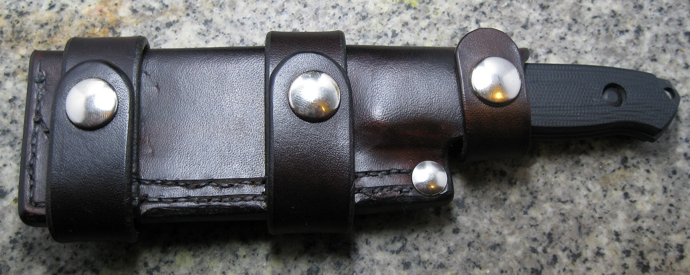

Well this is the final one for this knife except for the resizing of the other sheath that was to long to grab the knife. I wanted him to try out both styles for me. 5oz leather doubled up for the back and front with a 8oz tapered welt. Used angelus dyes on this one, first coat was spice, then coffee on top of that. I sealed it with my neatsfoot/beeswax mix to see how that does. I use cordoven dye on all my edges followed by glycerine soap shaping and bees wax burnish. Guess Ill see how it works once he gets ahold of it and plays around for a while. Originally I wasnt going to do the little strap keeper at the top but wasnt confident that the knife would stay put while hiking around and camping and such.
