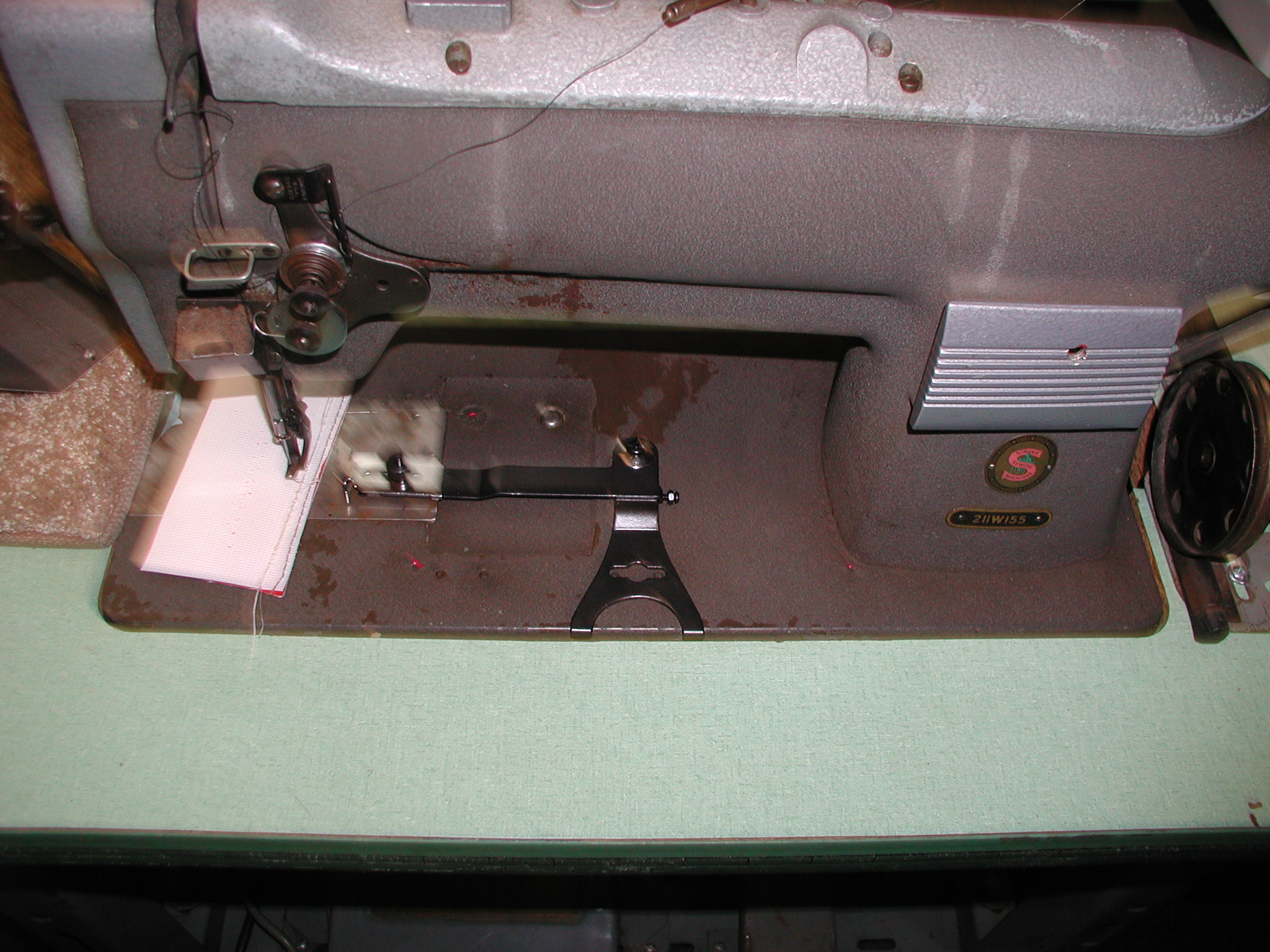

  1. The 95 is a shortarm 7" 96
  2. Art is correct they use these alot for lightweight binding,the largest thread is #69 & they won't sew very heavy,They were made for lightweight work like underwear binder in cloth .They also use them for sew hat bands on. Bob
  3. That's a Singer 95 class made for lightweight sewing for tailors ,drapes & etc,it might sew chaps in a pinch with #69 or#92 thread. It's a good price if you can use it. Bob
