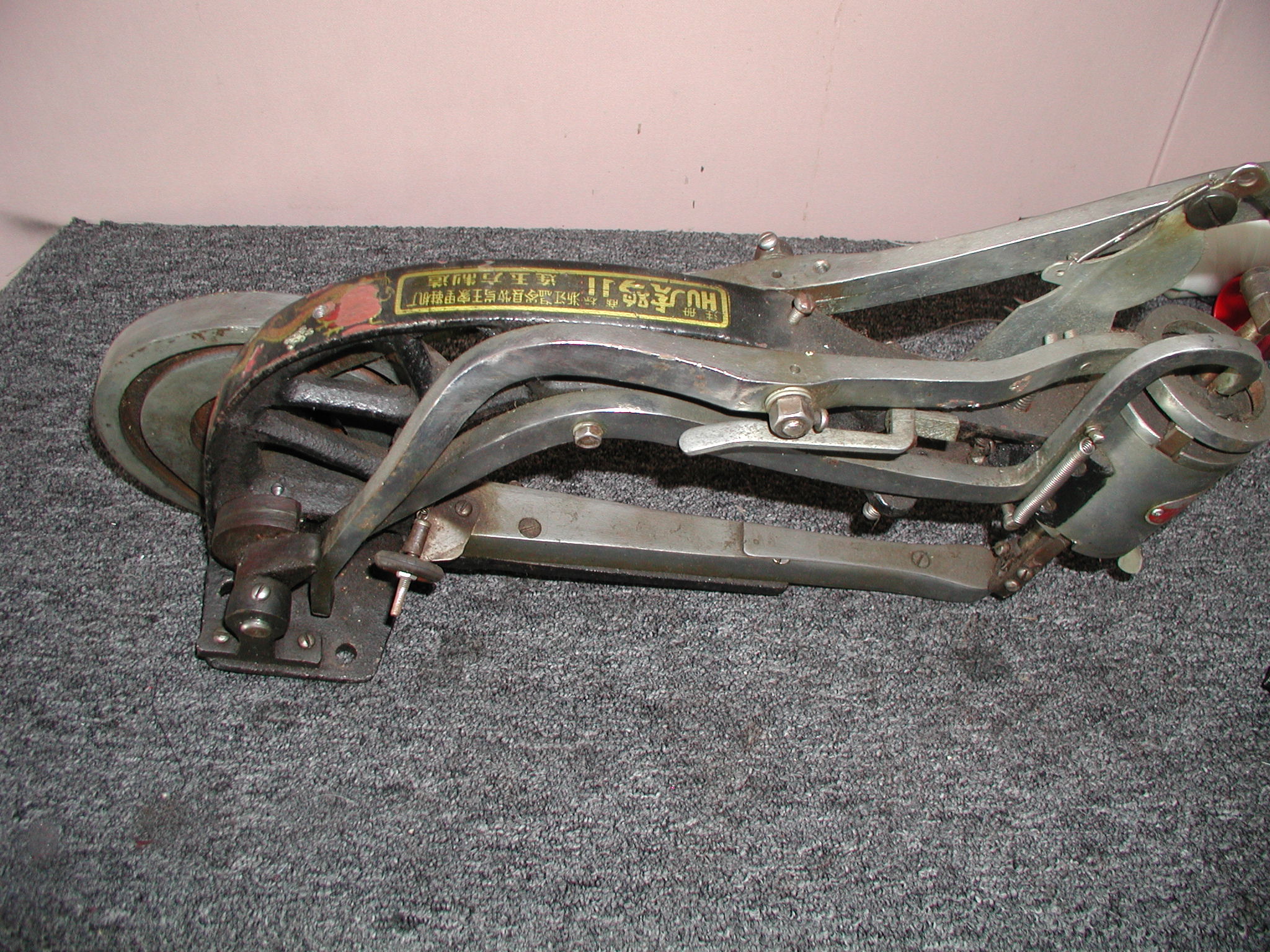

  15. I don't know what brand machine that is but can tell you it's a single needle chainstitch used in collar making,luggage making.It's alot like a Puritan. I probably have needles & awls for it.
