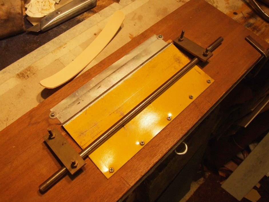

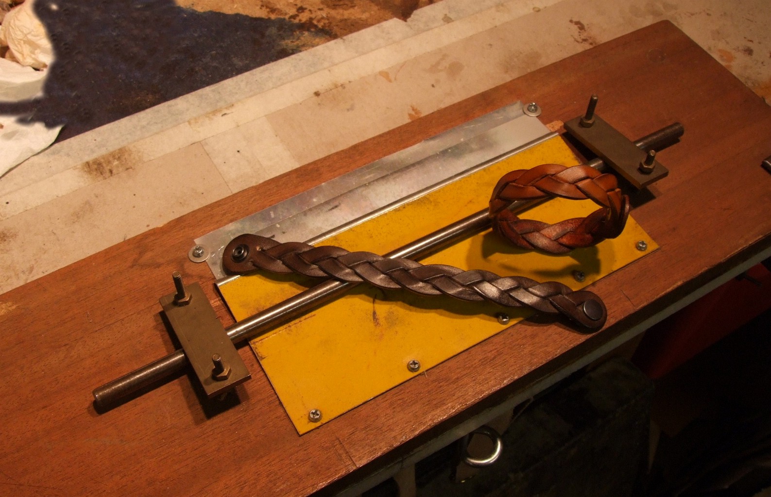

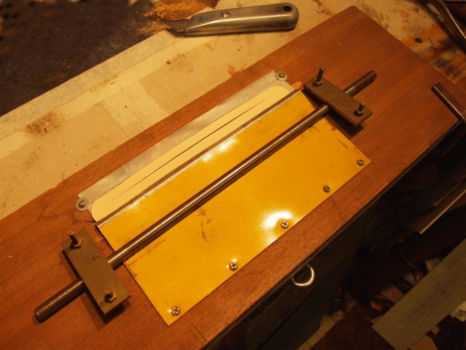

Here's a gadget I made to avoid nipping off my fingertips when I make the parallel cuts in 3-strand and 5-strand wristbands. I'm not sure if the pics give a totally clear idea of how it works. The leather strip is placed under the yellow plate, against an adjustable stop (hidden beneath the plate). When the steel rod is pushed forward (pic 2), the edge of the yellow plate nips the leather evenly along its edge and forms a straight-edge for cutting. The leather is then turned around and the second cut is made (pic 3). A small hole at the end of each cut makes the leather easier to plait. Pic 5 is the finished result - dyed and plaited. I haven't patented it yet, but there's still time . . .
