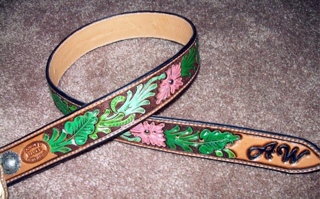

I haven't posted anything in a while, so I thought I'd put this up. It turned out okay...typical flaws that I wish I had a muligan to fix. Oh well...someday I'll get it all figured out. Let me know what you think. Thanks for looking.
ClayB hit the nail on the head. I do alot of bargrounding rather than backgrounding, but if I try to do it when the leather is too wet, I get stretching and uneven work. The bargrounding is the very last tooling I do on a piece, and the leather is very nearly dry. It's still moist enough to make the tool marks dark, but not much wetter if that makes sense.
