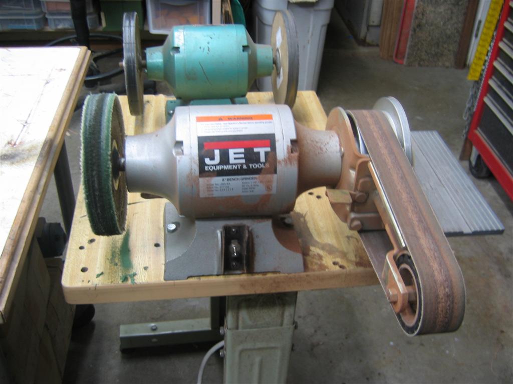

What sort of sander do you use for edge sanding
hidepounder replied to UKRay's topic in How Do I Do That?
It's been a great tool! It's called a Multitool. They also make a Portagrind, which I have also, which attaches to a hand grinder. They are manufactured by P.A. Products, 6 Barry Ave, Mortdale 2223 N.S.W. Austrailia -
Ray, I use a belt sander more than anything else. For small curved edges I use the little drum sanders. I have a series of different sizes that I use on the end of my burnisher or I put them in a dremel. But 99% of my sanding is done on the belt. -
