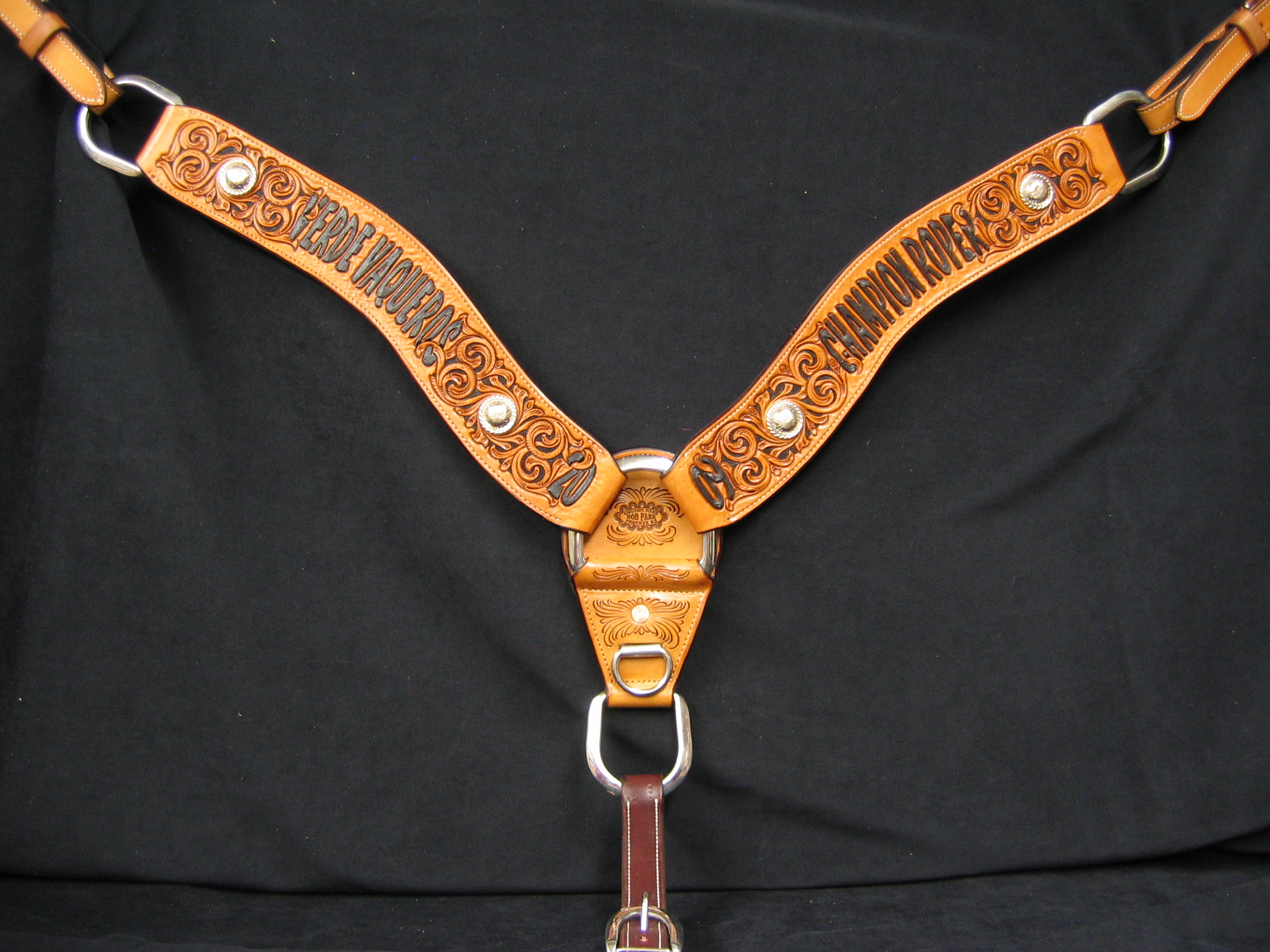

Here's a photo of a roper breast collar. This style is also contoured to ride above the horses shoulder to minimize restriction of movement at the shoulder. The breast collar is constructed of 11/12 oz skirting which is skived and folded back around the three connecting dees. I then back the skirting with 9/10 oz Califronia latigo which is also skived to fit smoothly at the dees. I install a 2" dee ring below the main dee so that the lower tug strap can be easily replaced. That is the piece that becomes saturated with sweat and becomes stiff and hard. It is constructed of doubled 9/10 oz latigo and all my hardware is stainless steel. There is a 1" dee attached to the center piece so that a strap may be tied to keep a tie-down from drooping. All pieces are glued with Barge or Masters and then sewn, including the side tugs, which are lined. This is probably a more complicated way to build a roping breast collar than it really needs to be, but I've never had one come apart! Hope this gives you some more ideas. Bob
