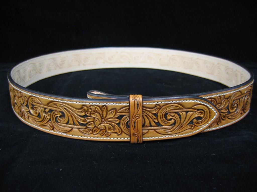

Here's a belt I finished this weekend. This is one of my own patterns....it's not new, you've seen it before. I wanted to do something a little different when I drew this, so I wrapped the pattern around the borders. I like it but it makes it pretty slow to tool. The leather is 7/8 oz grade A, HO, with a 2/3 oz finger cut lining. The finish is Fiebings Cordovan dye, Fiebings Lt Brown Antique and Neat-Lac. Stitching is 138/99 at 9 spi. I can't decide which I like better....138 or 99 on top. Any opinions? I also lined the keeper, but I'm not sure why....you can't see it! As always, I appreciate critiques and suggestions! There's always room for improvement! Bob

Thanks Luke, Just happened to have finished it last weekend and had a photo which showed the lining. Bob -
