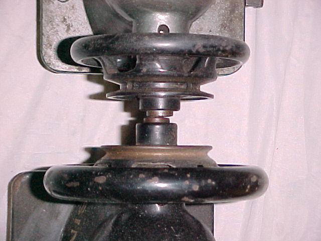

Hi James, There were two sizes of hand wheels that came out on the 31-15s. The Singer parts manual shows a large 6-spoke wheel #2135 and a smaller 5-spoke wheel #12358. I'm not sure if they are readily interchangeable, but I only see one hand wheel collar in the parts book. I have two 31-15s, one with each size hand wheel. In appears that the older model 31-15s that originally came out in a treadle stand or a convertible treadle/electric stand may have had the larger wheel to accommodate treadle users that started the machine with a hand motion. I haven't actually tried swapping the hand wheels on my 31-15s, but I know the larger one won't work on a Singer 96-40, because I did try that. CD in Oklahoma thayerrags.com
