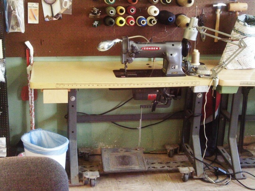

I want wheels under all of my heavy machines. They’re just no fun to carry around at my age. I have a Singer 20U33 on a power stand that doesn’t have wheels, and although it doesn’t get moved very often, I want to get wheels under it someday. My Consew 225 came to me with wheels already mounted on the power stand. They are mounted with metal brackets to keep the stand just slightly above the original height off the floor. All 4 swivel, and none of them lock. The machine will tend to move around while in use, if not blocked by a wall or table, but it’s used once in a while out on a sidewalk, so I’ve got to have wheels to get it out there. The casters are a nice heavy weight, but the brackets allow enough flex for the stand to wobble. It’s not the best setup, but can be put up with. I built a 1x4 wooden “trolley” under my first Singer 29K70 treadle. It’s a rectangle on casters. The 2 casters on the needle end are rigid, the 2 casters on the handwheel end swivel. It works well with this configuration. Concern for putting stress on an individual cast iron leg of the stand while moving it (something unexpectantly blocking one wheel) caused me to want to spread any stress like that onto the wooden trolley. I built a 1x4 wooden trolley under my second Singer 29K70 treadle. It’s similar to the rectangle trolley, except it’s in the shape of an “I” with only a single 1x4 running across from end to end of the stand. Rigid casters on the needle end, swivel casters on the handwheel end. Works as well as the rectangle, but with more foot room. I’m not sure if I have the same protection for the cast iron stand legs. I added 1x4 boards and casters under the ends only on my Singer 111W153 H-leg power stand. The stand feet are hollow with a narrow support surface around 3 sides, so the boards provide a flat surface for the casters and feet to mate up. All 4 casters swivel, but the 2 on the needle end can be locked. They’re a dual-wheeled type of caster that I got from a homemade furniture dolly that I picked up at a yardsale. They’re heavy duty enough, but I think eventually the wood will compress under each foot and will get loose, so it’s probably only good for a temporary installation. I roll this machine out of its storage area for every use, so I had to have wheels under it quickly, and that’s what I came up with. I’m now trying to decide how best to put wheels under my cast iron Singer 31-15 treadle stand. I bought some post casters that will bolt directly onto each foot, but I’m still leery about putting stress on the legs if one wheel gets blocked. CD in Oklahoma

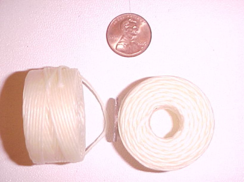

I came across a box of large-sized Heminway & Bartlett waxed nylon thread that is labeled as “Nylshu (Registered) Littleway Bobbins” that is “Size 7-m” & “Model-D”. I’m going to market it as a general-use craft thread for hobby customers that want a large thread for their projects, but I’m curious as to its original use. The Nylshu trademark makes me think of shoes, but I haven’t found much about the term on an internet search. Is anyone familiar with this thread? Also, the one photo shows a US dime on edge next to the strand. I’m guessing that the thread is at least as thick as the dime, so what size would it be called? Thanks. CD in Oklahoma

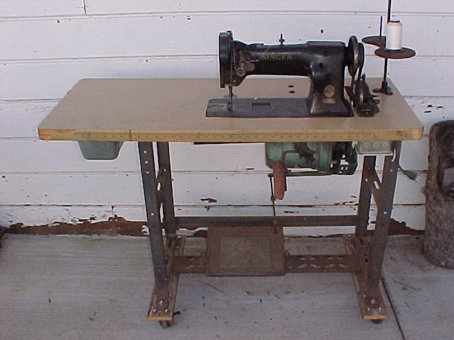

I recently sold one of these to a boot maker in Texas. It’s powering a 1939 Singer 31-15. I used the machine for a short time, test-sewing with it by making a fitted cover out of billboard vinyl. I was impressed with the slow stitching control that I could get out of it. The new owner had thought that he would want to replace it with a Servo motor, until he tried it out. Now he’s thinking he’ll just use it as-is. I’m going to keep my eye out for another one for me. CD in Oklahoma -

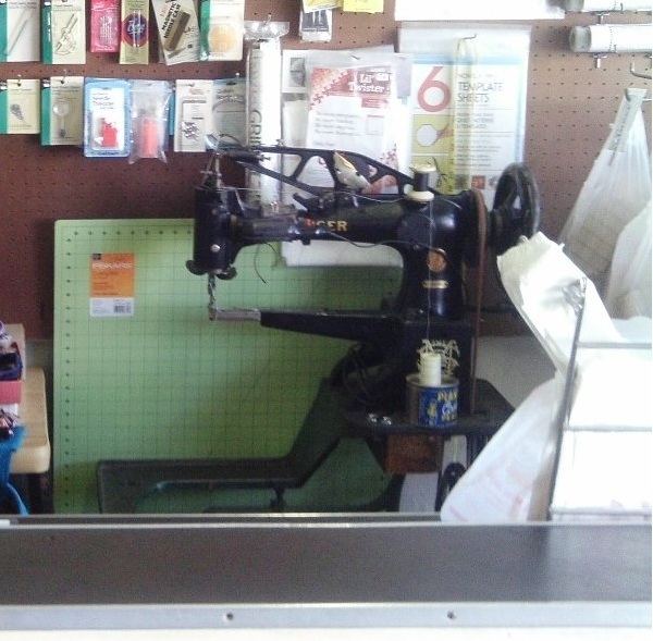

I share my 4 ounce spools between my Consew and my patcher. I was using my patcher yesterday to sew reinforcement material for grommets onto a re-purposed tarp. I’m in the process of making three 2’x10’ fitted covers out of old 15’x’50’ billboard fabric for the seed boxes on a Sunflower drill. I happened to look down into the bottom of the boot top, and there was my Planter’s Peanut can! I’d wondered what I had done with it. I need to rig up a thread cone holder for my other 29K70 that I keep at home, so I may use the can until I can get another boot top made. It’s not on casters and I don’t use it much, so it hasn’t been a problem. I wanted to use the boot at the shop for a while to see how it worked before making a second one. It seems to be working just fine. Lashing the boot top to the pillar has kept me from having to chase a thread cone across the shop since I started using it. I’ve been saving my old Justin Roper boots for years, wondering if I would ever get the equipment and skill to re-sole them. So far, it still looks like it ain’t going to happen, but I’ve got a lot of boot tops. I made my belt-mounted cellphone case out of the mate to my thread cone boot, so I’ll have to break-up another pair for a second thread holder. BTW- Boot tops make good little fence staple bags, now that we don’t see canvas water bags much anymore. I made one back in the 70s and used it a lot when I was still maintaining fences. I still have it. CD in Oklahoma
