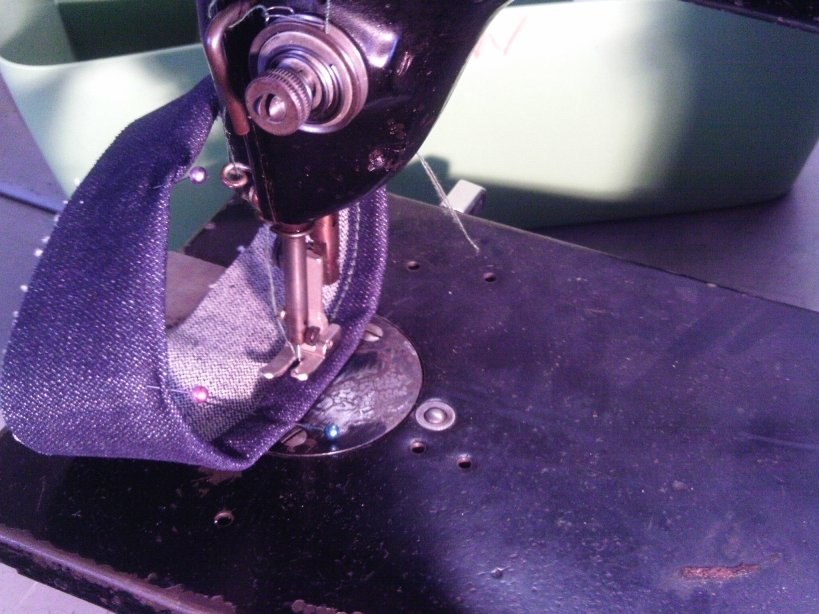

What are you planning to sew? I’ve recently been setting my Singer 95-40 up as a dedicated denim jeans hemming machine. It was designed for sewing light and medium weight fabrics, so it’s not really designed for heavy work or leather. I was even concerned about how it would handle the cotton-covered polyester Tex80 thread that we use for jeans hemming, and while I’ve only done a few test-sew trials hand cranking it, it looks like it might handle it alright, but Tex80 is probably close to the largest thread that it will like. I’m using a size 18 needle for woven fabric, sewing through 3 to 6 layers of new blue denim fabric (six layers when I cross the fake flat-felled side seams). I’m going to have to run it more to find out how the bobbin case gets along with the jeans thread. To achieve the tension that I wanted for setting the stitch in the denim fabric, I swapped out the light-weight bee-hive spring in the upper tension with one out of a Singer 31-15 to avoid having the spring nearly mashed flat. So, if it was the original spring, which I’m guessing it was, that told me that my thread size may be above the intended limit for the machine. CD in Oklahoma

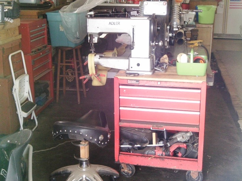

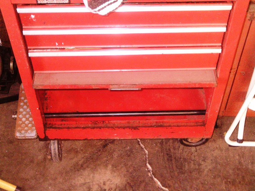

I got a foot presser bar lift rigged up on my Adler 205-64 that I have mounted on a 3-drawer, 1-compartment Popular Mechanics toolbox that I happened to have had available. I think the foot lift is going to work fine, but I haven’t sewn anything with it yet. I sewed some on a dog leash the other day, and sure wished then that I’d have gotten a foot lift on it sooner. The only lift that I had was by hand on the foot lift actuator lever. I haven’t replaced the hand lift lever parts that are damaged yet, and I have to release the tension manually each time. I power the machine by hand from a seated position using a steering wheel spinner knob on the balance wheel. I drilled a hole with a step drill bit in each side of the cabinet, as close to the bottom of the lowest compartment as I could get. Then I put 1/2” black rigid pipe across through the holes, added an old Singer foot plate that I had, a shim on either side of the plate, and put hose clamps on both ends of the pipe to keep it from walking out one end or the other. I used 1/8” plastic-coated cable and cable clamps to attach the peddle to the foot lift actuator arm. The cable doesn’t rub the edge of the cabinet very hard, and it’s rubbing on wood, so if I get a groove worn I’ll put some kind of metal shim under the cable to protect it. The whole set-up looks Redneck, but it’s just perfect for a small repair shop like mine. Cost of the new parts was about $15. CD in Oklahoma

I like to see shop-built solutions like this. Thanks for posting. You really went all-out on the speed reducer, but is the foot-lift made out of heavy enough material to hold up? I’ve got to get busy and rig up a foot-lift for the presser bar on my Adler 205-64, and then learn how to use it. All of my other machines have knee-lift presser bar lifts on them (that have anything other than a hand lever lift). Having my machine mounted on a mechanic’s tool box will make rigging a challenge. CD in Oklahoma -

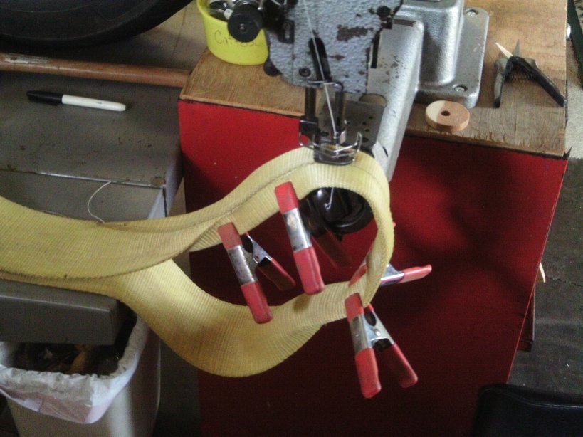

This afternoon I fiddled with my Adler 205-64 Handcrank. A friend of mine broke his big tow strap close to one end, so I sewed a new eye into the end to rebuild it. It’s the first real “project” with the Adler, and I’m pleased with how it sews. I really do need to get to work on rigging up a foot-operated presser foot lift though. I found a peddle for it, but need to locate a piece of pipe to run across under the toolbox to mount it on. It’s something that’s really needed to operate the machine for any length of time. The eye splice took quite a bit of sewing, and my arm was starting to feel the strain by the time I was finished. One full revolution per stitch makes for a lot of cranking, but the steering wheel spinner knob works just fine. I think it will be just fine for these kinds of repairs, but wouldn’t be adequate for any type of production with the machine. CD in Oklahoma
