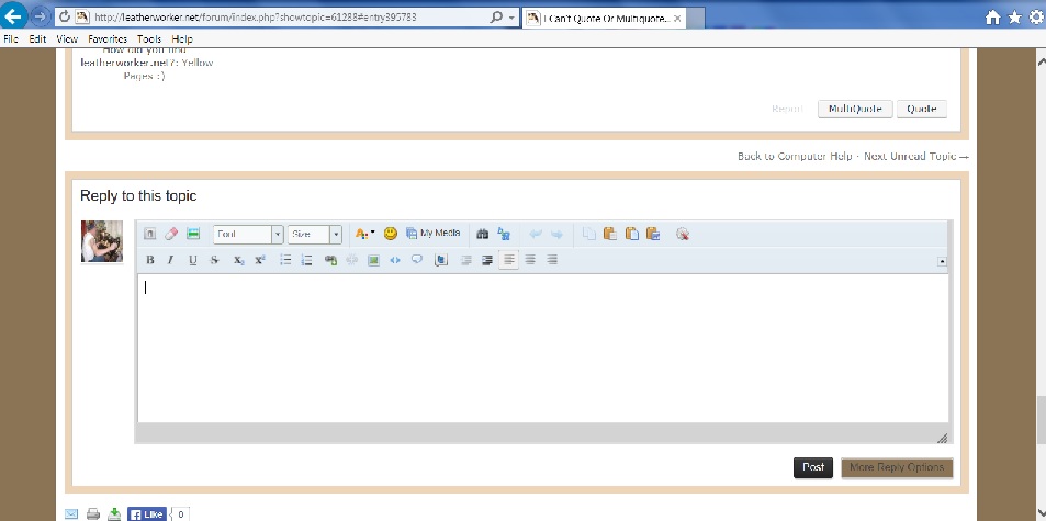

Tom, I have IE11. I looked back through my posts here at LW and found that my quote problems began a little over a year ago. My browser settings are: Security: Medium High, protected mode enabled. Privacy: Medium, but my Popup Blocker is enabled. I added this site to be allowed, but it hasn’t made any difference. I’d like to keep the blocker on if I can. Java: For some reason, my Java wasn’t enabled, so I enabled that, but it hasn’t made any difference. I guess I’ll just have to live with it. It keeps me from babbling too much anyway. CD in Oklahoma
Thanks for trying to help, but it still won’t work. I’m using Microsoft Internet Explorer. In the screen shots below, 1 - I clicked on “MultiQuote” and got this additional button. 2 - I clicked on “Reply to 1 quoted post(s)” and got this screen. 3 - I clicked on “MORE REPLY OPTIONS”, and got this empty text editor. CD in Oklahoma
Thanks for that information TwinOaks. Maybe that explains why the quote quit working for me a few months ago. I tried to quote your post, and got a blank text field. I haven’t posted much in the past year or so, partly because I can no longer quote text that I want shown with my response or question. CD in Oklahoma
