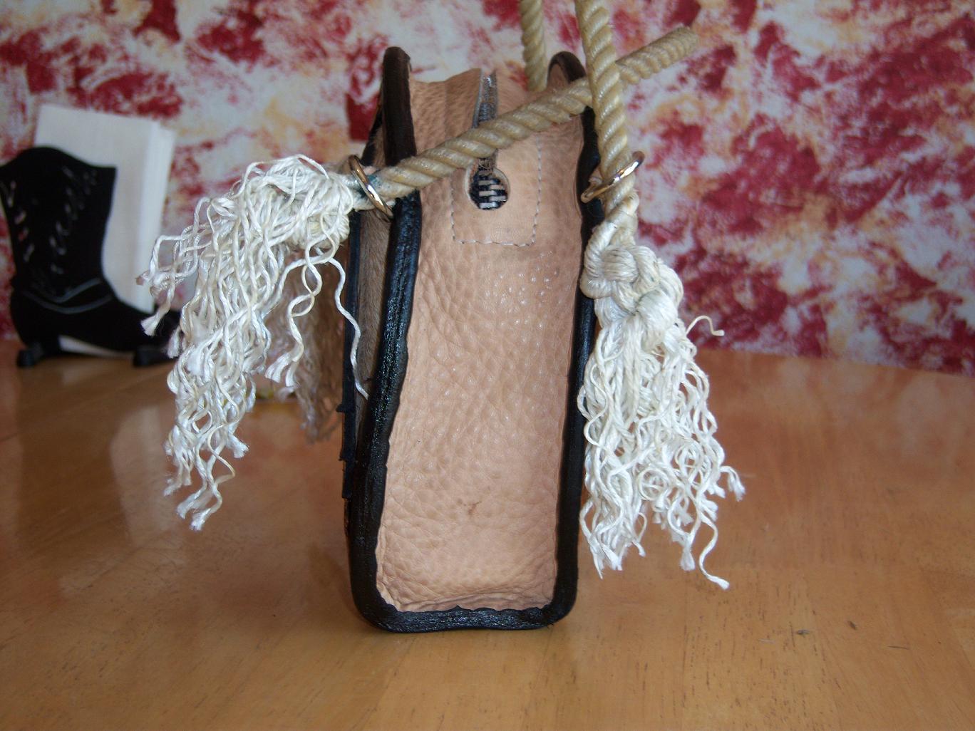

Heres the latest since the sling came off. Dont be too hard on me it has been a while. and this is my first attempt at fillegree
well I am always takin orders or if you want to pm me I will help you however I can. you know I have thought about doing something like that but she likes to change the buckles on a moments notice (women). this so far has worked out pretty well for me but I want to refine it some for sure.
It is Kind of hard for me to put into words as I am a visual hands on type but I will do my best. there is a slit in the hair where the loop of the buckle (where it would attatch to the belt) goes through, and there is a belt inside the purse thats about as long as the buckle. so you put the bucke on the outer belt (the one you can see) put the loop through the slit in the hair, and then just put the inner belt through the loop as well, when you first fit it up you pull the outer belt somewhat tight and punch your hole for the pin so there is a little bit of tension and it will stay. I have done five or six of these purses now and havent had any of the buckles come loose yet. if you have another way that you think might be better I sure would be interested as I am always trying to learn another way to do things. Thanks for the kind word as well I too like the ranchy look. I was trying to figure out a better way to attatch the rope handles but that is what I came up with. I am open to any and all suggestions.
This is a purse that I made for my wife. This is my first attempt at fillegree, i dyed the backgrounds and they were way darker than I wanted and you couldnt see the brand. I need to work on my tooling I know but this is the first project after being in a sling for 6 weeks for the second time. Since two shoulder surgeries in the last six months I get real sore and shaky real fast and I got real rusty real fast but I had to post it since I said that I would, even though I am not real happy with it. The next one will be alot better since I get a little stronger everyday and it is coming back to me, slowly but it is gonna come back(I hope). Let me know what you all think as I have fairly thick skin. I hope you enjoy.
