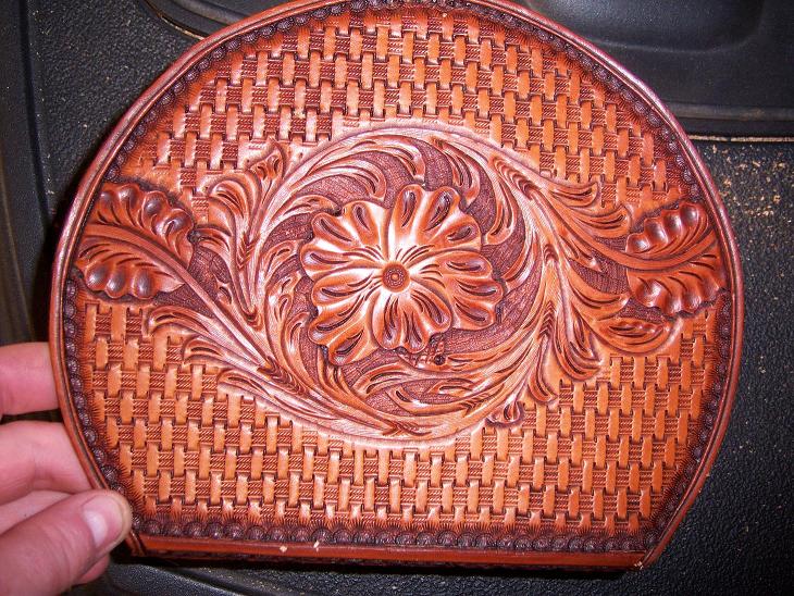

Latest Carving project
Tkleather1 replied to Tkleather1's topic in Purses, Wallets, Belts and Miscellaneous Pocket Items
Ok now I understand what you are saying. my decorative cuts got way out of hand on this one for sure. I dont know if I do them right or wrong, this forum is the most "training" I have ever had. I too like it when people tell me what to do or not to do i just sometimes dont understand what you are trying to tell me, as again I am pretty much self taught with guidance here and there(mainly here) I thank you all for any info that you have or will give me in the future. Tim -
I like it. one question though you mentioned that I needed a thumbprint to make my flowers look less flat, no offense but I feel like yours look just a little bit flat as well I dont totally understand. Dont get me wrong I think that it looks fantastic and a heck of alot better than I can do I jsut dont totally get what you are trying to tell me. gotta remember I am just a cowboy that got hit in the head a few to many times. Tim
No I agree with almost everything that you have said. you are 100 percent correct about the shader and the cuts I got way out of control. I dont get why you think the basket is wrong, I have done things this way, your way and diagonal so what is wron about it? As for the turnback I have never used one and wouldnt even know where to start, I would appreciate info on this as well. Now I want to make it very clear I am not trying to argue I just dont understand a few things and thank you very much for the input. Tim Some of the guys on here were talking about the sun tanning, and it works you oil it up and put it in the sun and it almost looks tanned. the Saddle lac is for a resist. that way the antiquepaste dosent get on everything just the low portions. the Tankote and the topcoat of Saddle lac are just a finish. I might have overdone it but its the only way I know. -
I hate the way that the rattle cans spray they are very uneven. I hate even more that we have to resort to them since there is no more Neet Lac. what I have been doing is spraying it liberally onto a peice of shearling and applying that way, I get a way better finish.
Here is the first project that I have done with the new tools from Barry King and the first side of Herman oak leather that I have purchased. I am pretty happy with it. as always there are things that I will change next time. This purse will be lined with black 1.5 oz. Swine and have a black chap leather gusset I havent decided what to do for handles yet I would like to do round handles but I dont have a rein rounder so I will have to figure something else out. if you have any suggestions let me know. I should post this in the critique section but I will just tell all of you to let me know what you think so far. The finish is one light coat of extra virgin olive oil, a day in the sun, two coats of Saddle lac applied with sheepskin (not sprayed) one coat of Feibings sheridan brown antique. I still have to put the final finish on ( one coat of Tan Kote and one coat of Saddle lac) So have at it and let me know what you think. Thanks to all Tim
