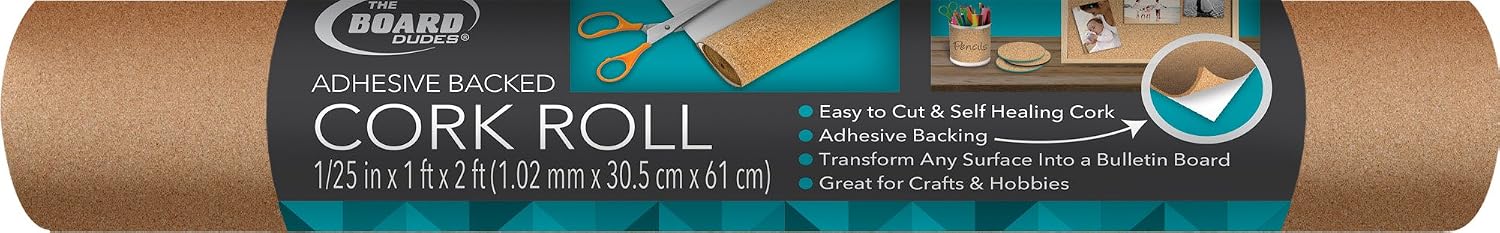

lonesome dove Report post Posted March 14, 2018 This is what I used. Thin with an adhesive back and inexpensive. https://www.amazon.com/gp/product/B0079XLR3A/ref=oh_aui_detailpage_o03_s02?ie=UTF8&psc=1 Hope this helps. Quote Share this post Link to post Share on other sites

BrotherRon Report post Posted June 26, 2018 Hello, I purchased some self adhering cork from Amazon, three pcs 8.5 X 11. It was extremely cheap like $3.00. I put it on the back of my T-Square and NO MORE SLIPPING. Definitely worth the three dollars. Hope this helps you. God Bless Quote Share this post Link to post Share on other sites

BrotherRon Report post Posted June 27, 2018 On 3/14/2018 at 5:01 AM, lonesome dove said: This is what I used. Thin with an adhesive back and inexpensive. https://www.amazon.com/gp/product/B0079XLR3A/ref=oh_aui_detailpage_o03_s02?ie=UTF8&psc=1 Hope this helps. This stuff works great. I got the 8.5 X 11 sheets but it is the same stuff. Quote Share this post Link to post Share on other sites
