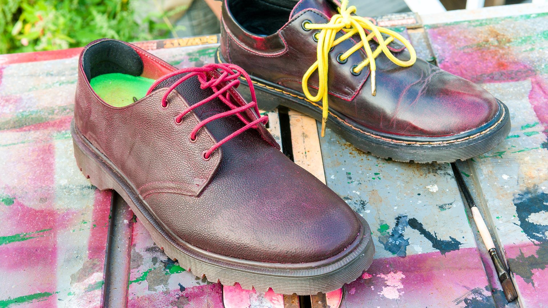

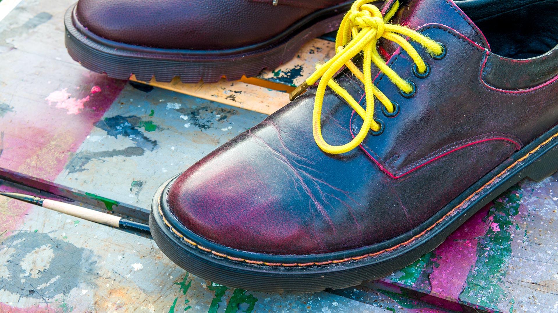

This how I do it in a nut shell: i) Apply Jojoba oil. The oil is undiluted and applied with +30 psi to the veg tan. Wait 24 hours. My theory is that with +30 psi the Jojoba oil is forced in the leather and causes the leather fibres expand to allow for better dye absorption. The reason I don't use Neatsfoot oil is there is a possibility of it going rancid and degrading stitching over a period of time????? ii) Apply the dye. The dye mixed with 99 percent rubbing alcohol at a 50/50 ratio and applied at +30 psi. Wait 24 hours. On the shoes (done August 2023) I used a Paasche airbrush with a psi setting of +45 psi. iii) Apply Jojoba oil to the veg tan. Wait 24 hours then finish. Here is a couple of photo's of one shoe from each pair of shoes (done August 2023) after two years of wear. Like @Dwight mentioned you can do some nice fading which can be seen being a lighter tone on toe and darkening to the body of the shoe. kgg

So the second oil is to draw the dye into the leather a bit more? Then finish? And thank you for that post, it's always good to hear how other people do certain aspects of leather work.
