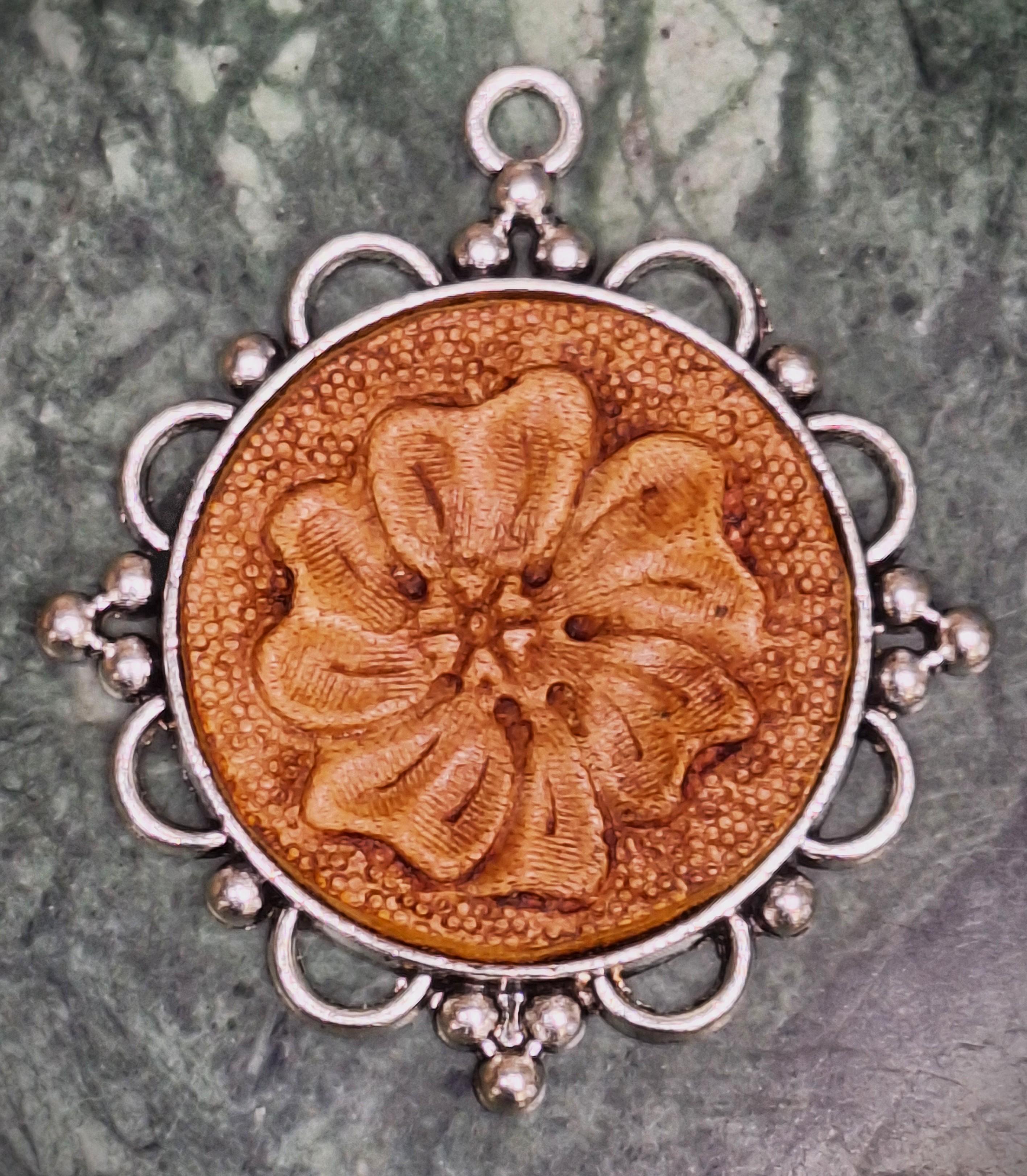

    Making the pendant for Gini was my purpose in tooling a tiny flower, this is a completed one and she was happy so job accomplished.

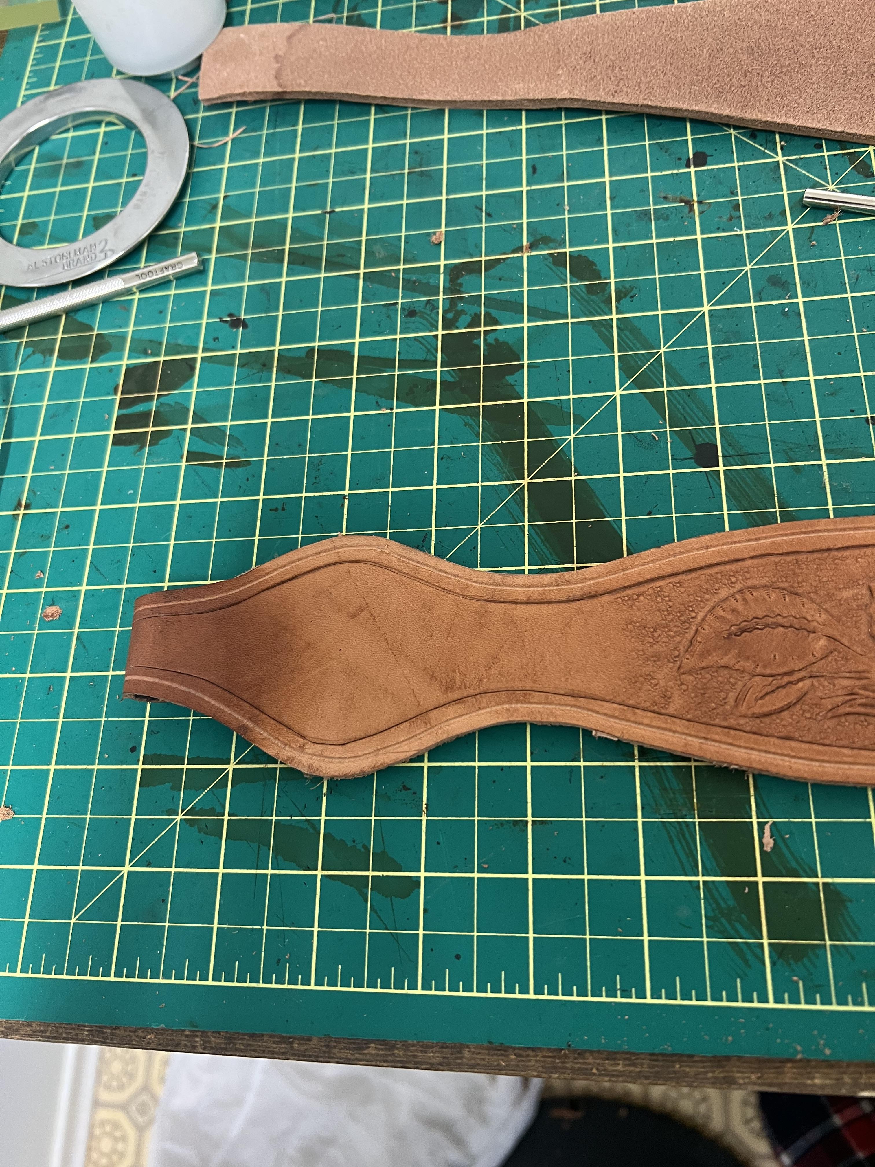

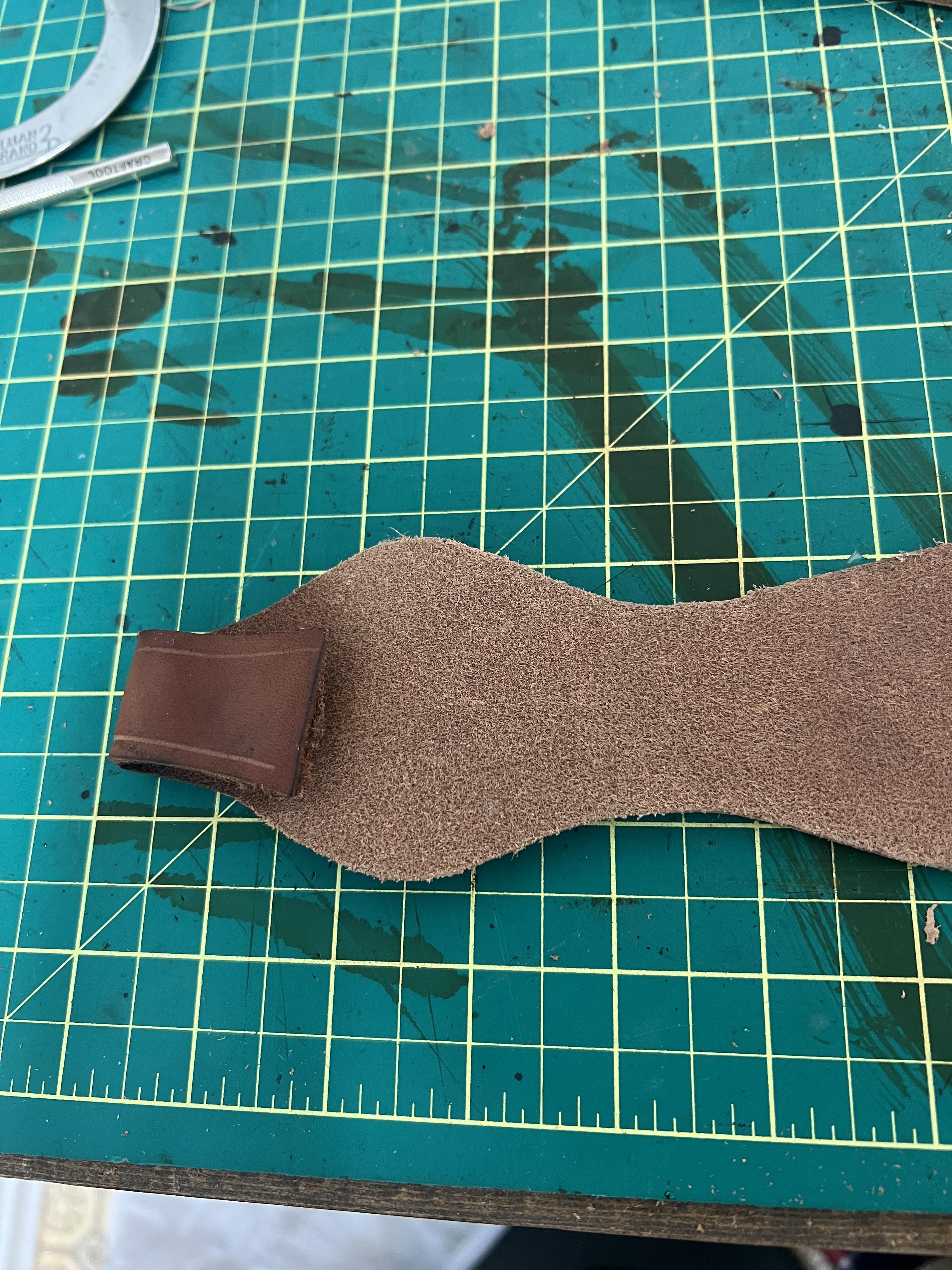

  5. Hi there, I’m making this breast collar from a template that wasn’t in hind sight super detailed. I’m trying to figure out the best way to attach it to the D ring, now realizing I should have given myself more length for overlap. I’m putting a concho on the circle portion. I’m wondering if the rivet from the concho and a couple of stitches will be strong enough or should I start over?
