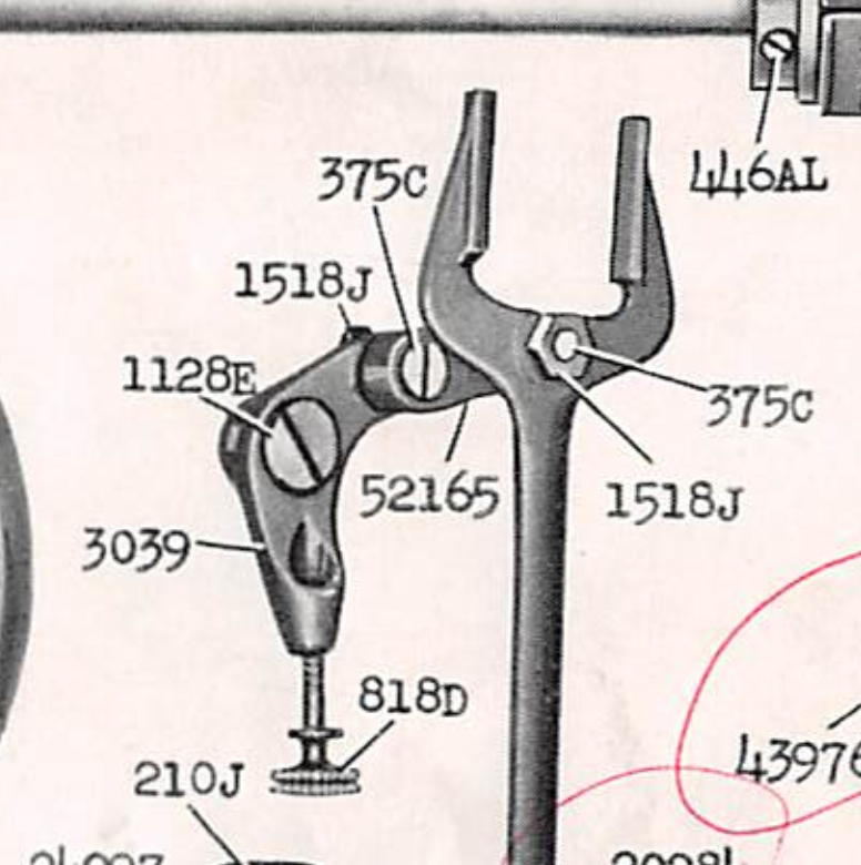

  2. The parts list for my Singer 31-15 shows more of these parts together as a group, which might be useful. Have you tried removing the stitch length adjustment screw (818D in this screenshot) ? With that removed maybe the whole cluster will slide out toward the camera..

  7. I have no doubt these motors are good (they're made by Hightex) but here they're a ridiculous price. I bought "generic" servos and built speed reducers for considerably less cost and they all work fine for my needs. I guess for commercial usage the cost isn't so much a factor - but how many factories want such a slow speed machine? In most factories the speed of making something is very important (time is money) so paying extra for a slow speed you don't need is wasting money. It seems to me it's a pretty specific (and limited) market this motor is catering for? Don't get me wrong, I'd love to change my servos for these but the cost would be absurd, ain't going to happen.
  8. How about diesel or other penetrating oil on the stud? How about tapping the tip of the stud with a long steel rod and a light hammer?
