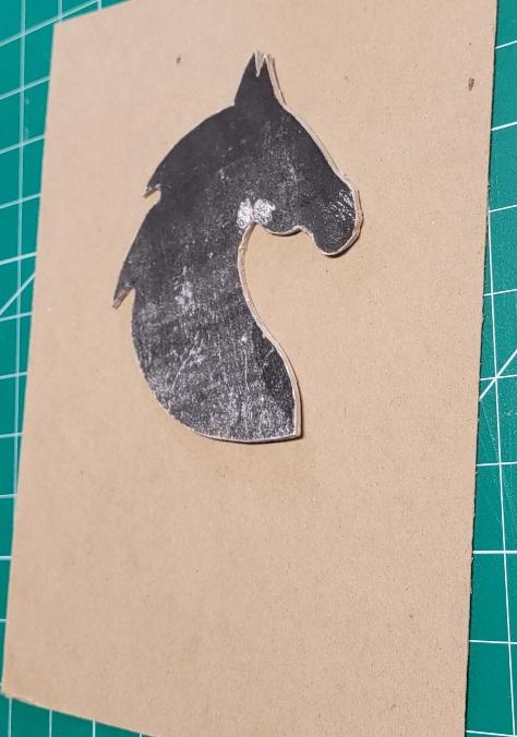

  8. and I did a little better on my stitching this time
