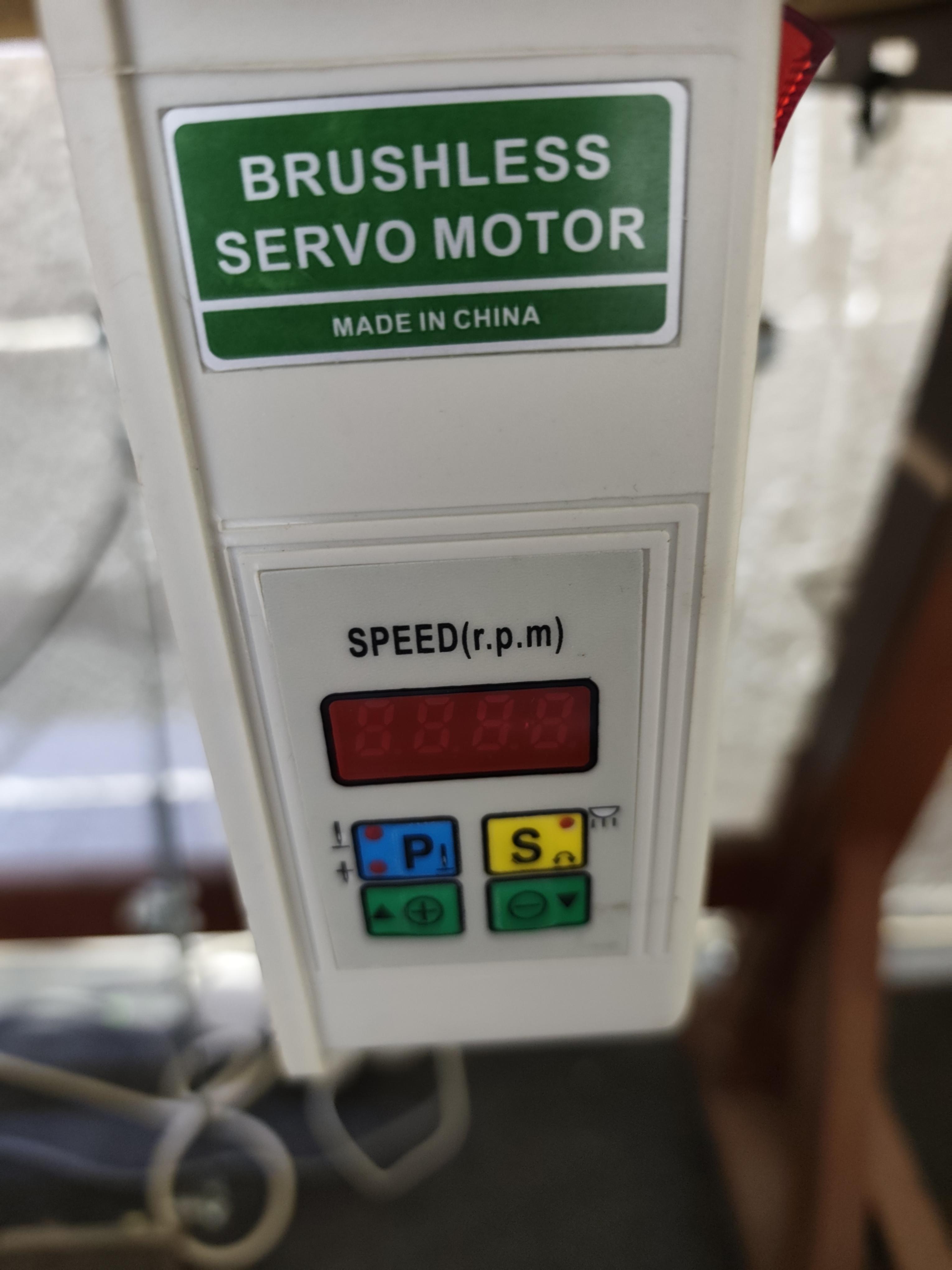

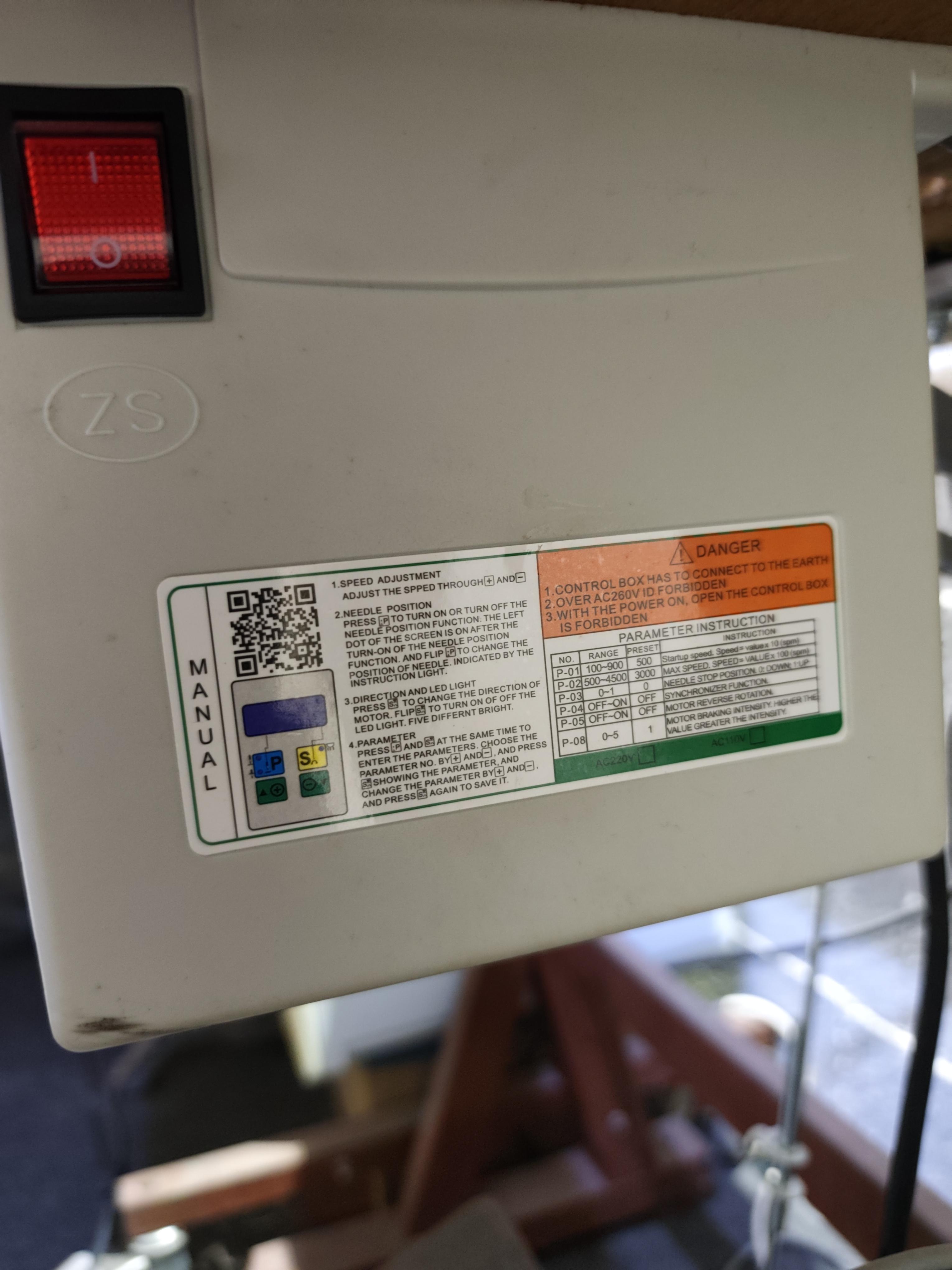

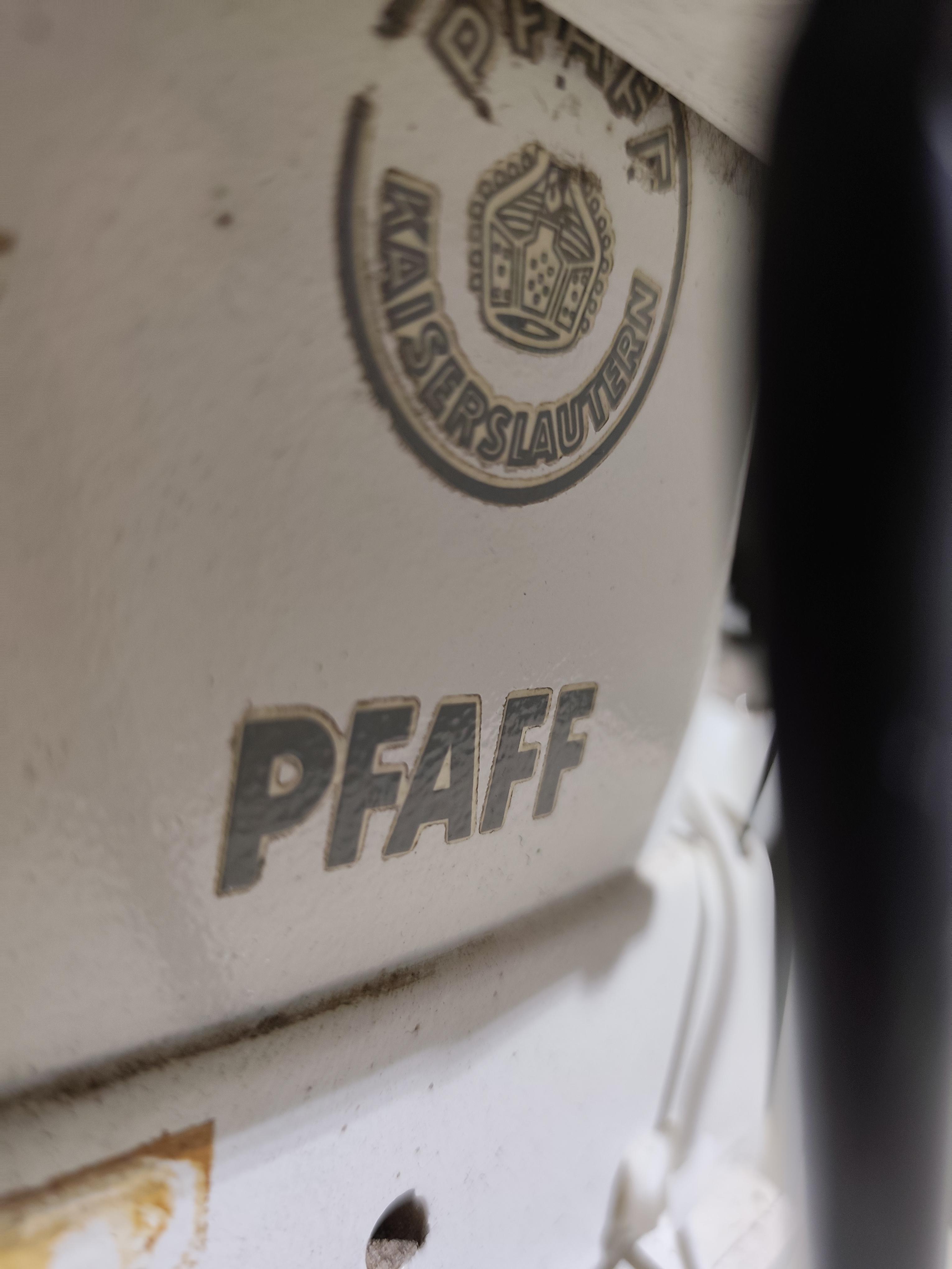

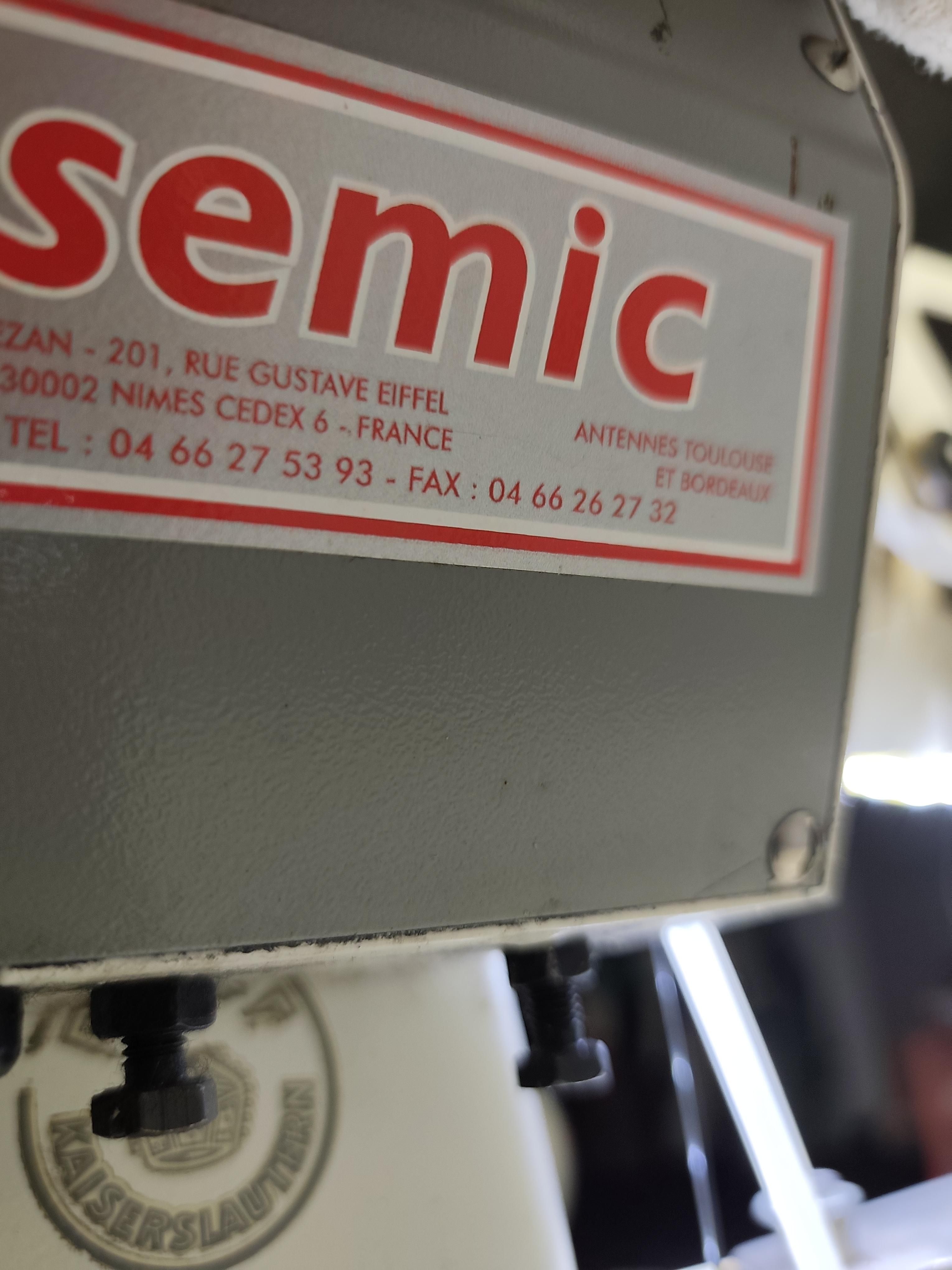

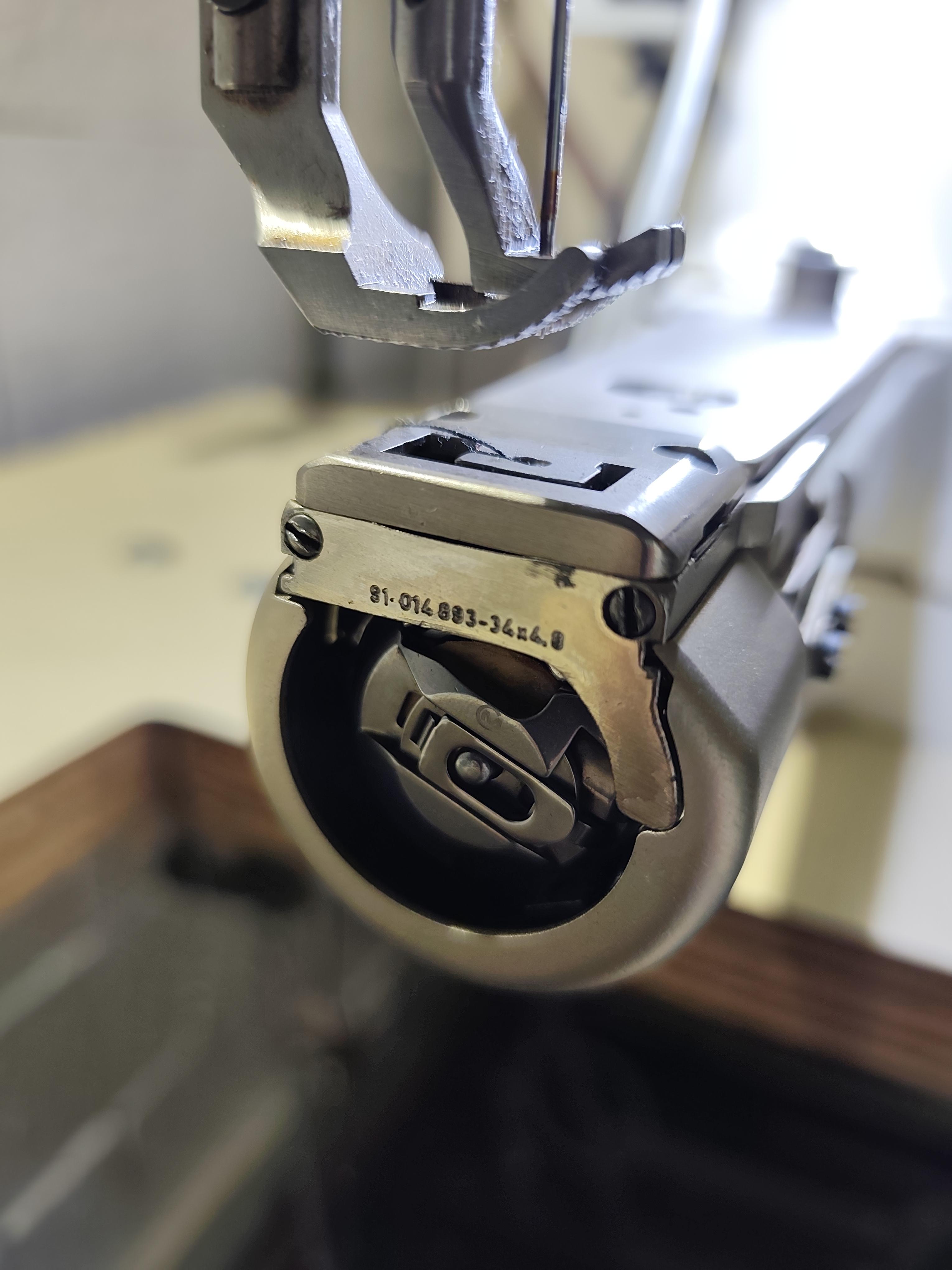

Hi, Can anyone tell me about this machine. There is no model stamped on it. There is a servi motor on and there is also the original motor available with it (no photos). I don't know what the box is on the back. Does anyone have a value on this and additional information please. Thankyou
