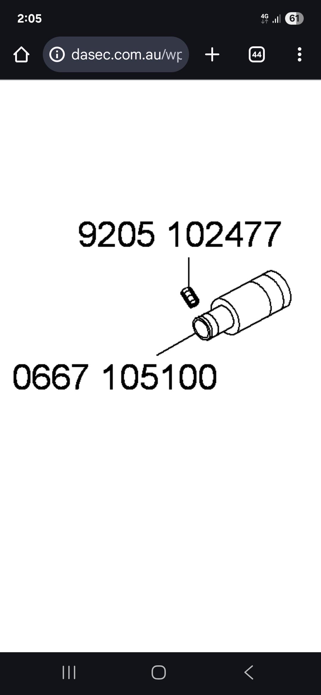

How to add needle positioner on adler 669
HarrySingh replied to HarrySingh's topic in Leather Sewing Machines
Hi Glenn, Thanks alot for the reply. Just checked on google the part no mentioned and find on 867 manual and the screen short of the part is this... Do it's needed to screw , I think their is no hole in Shaft or i may need to recheck. Do 600 watt [Hohising g60] in enough for 669? -
