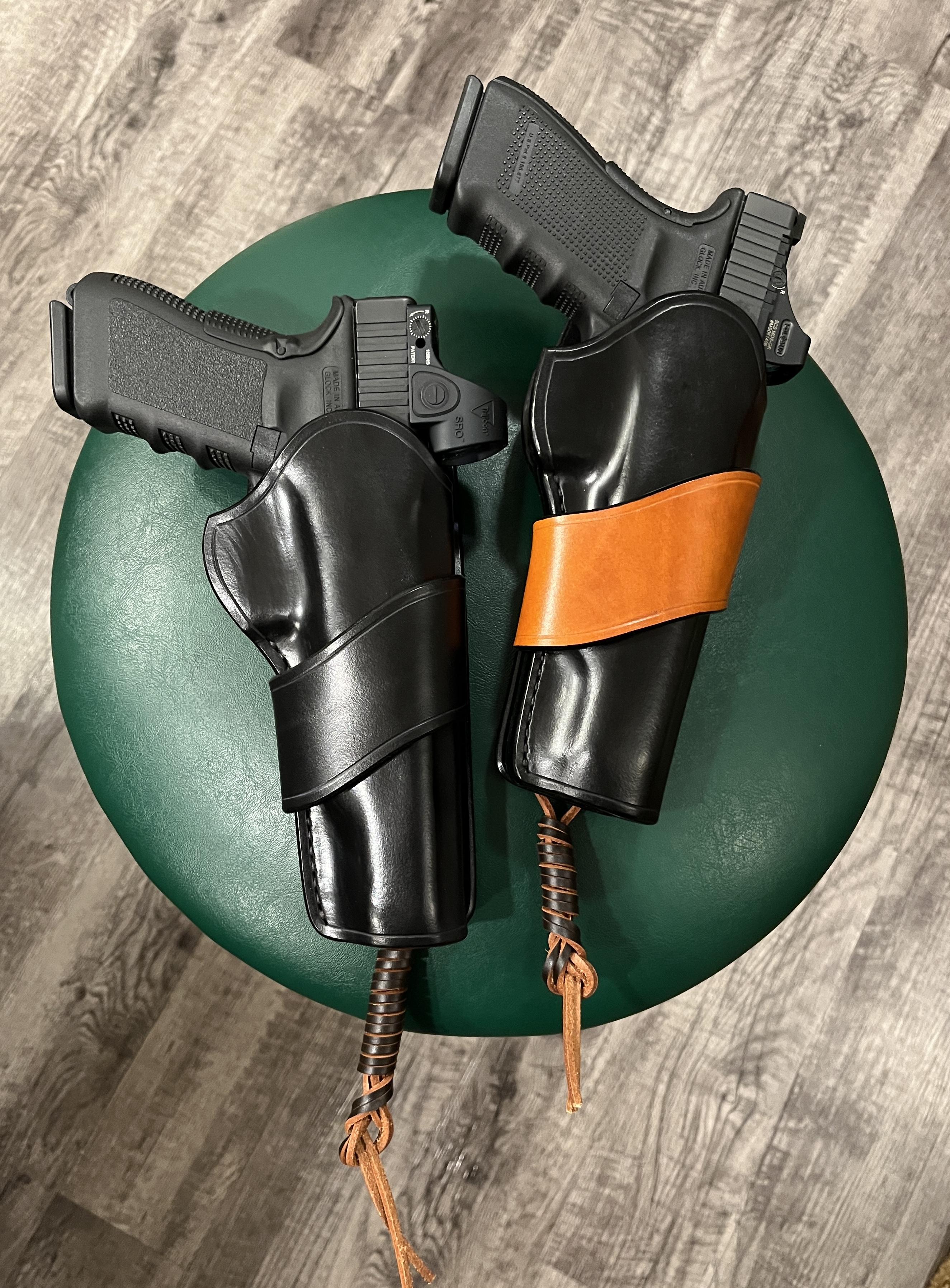

Those are very nice! It's interesting how you adapted the trigger guard cover from the S/A holster; don't often see that on holsters for semi-auto's, but it works very well. Larry - Today

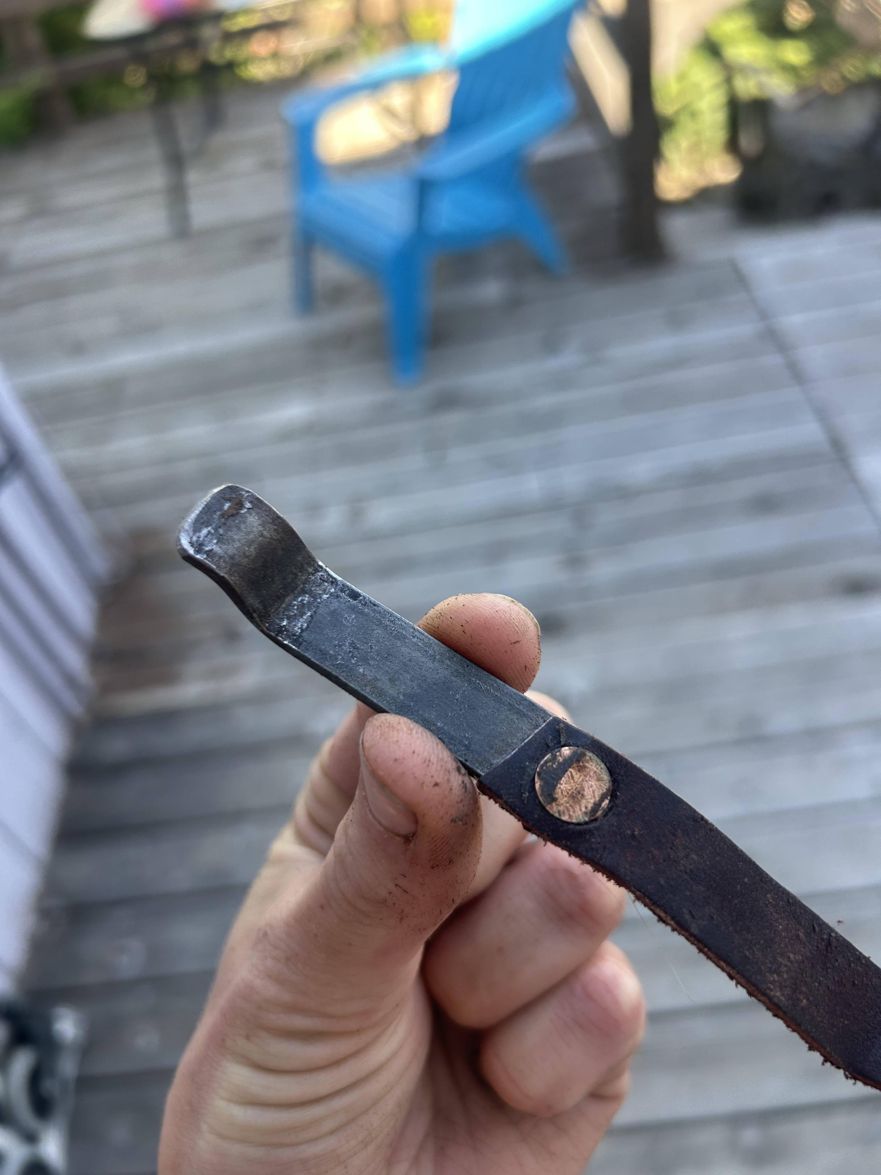

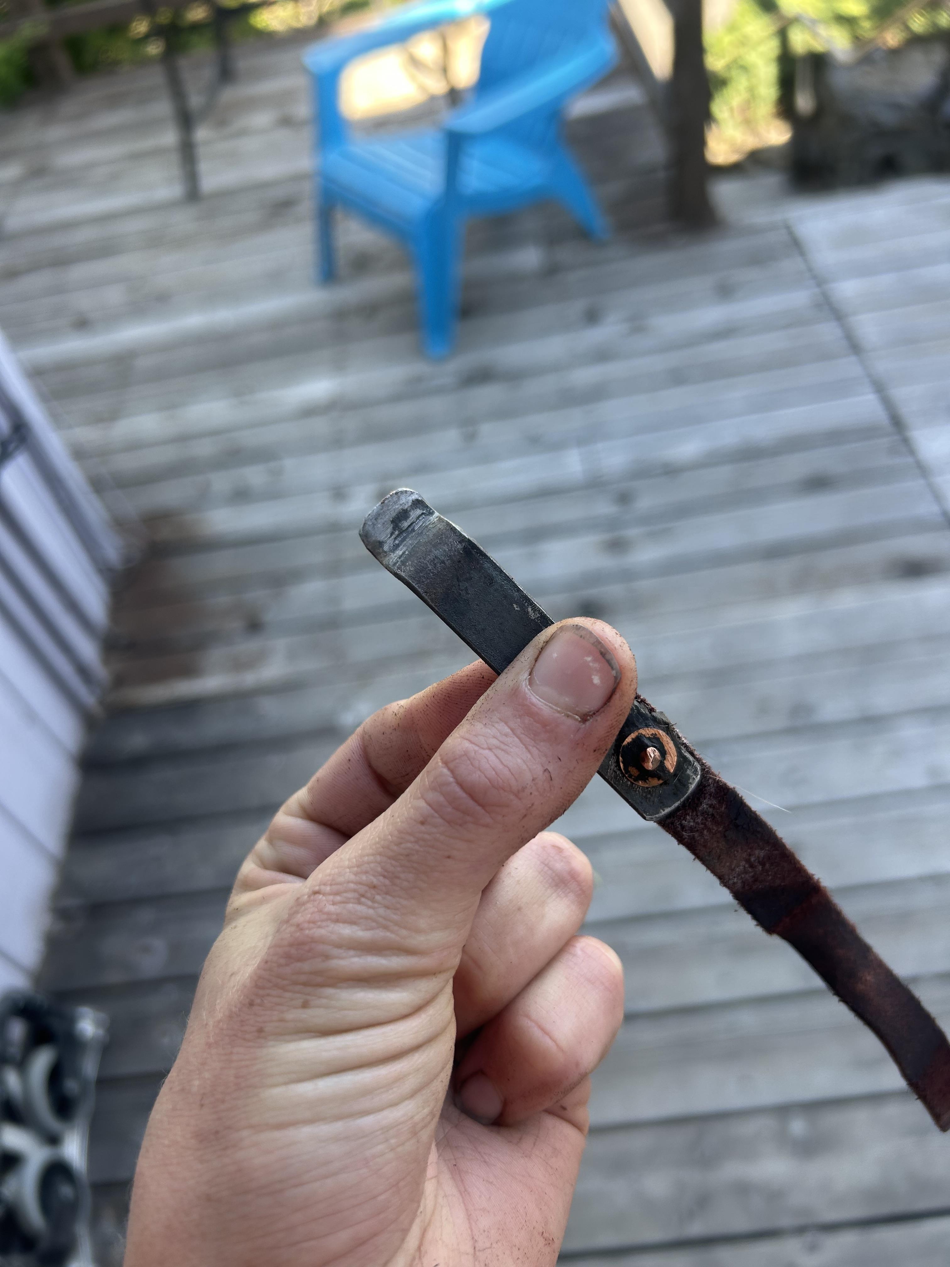

I have a western saddle made by Rick Mayberry/Sugar Creek Saddlery that has fixed stirrup leathers - one end is mounted in the front, down to the stirrups and then ran up through the tree, where a little bit of the stirrup leathers are held in place by a kind of pin that snugs up against the tree. One of the pins fell out and I am looking to replace it, but I haven't had any luck finding anything like it. I've been using one my of saddle strings to hold my stirrup leathers on my saddle and I would like a more permanent solution, ha ha. Does anyone have any idea on where to look? Or is this something I should look into having made? Thanks in advance

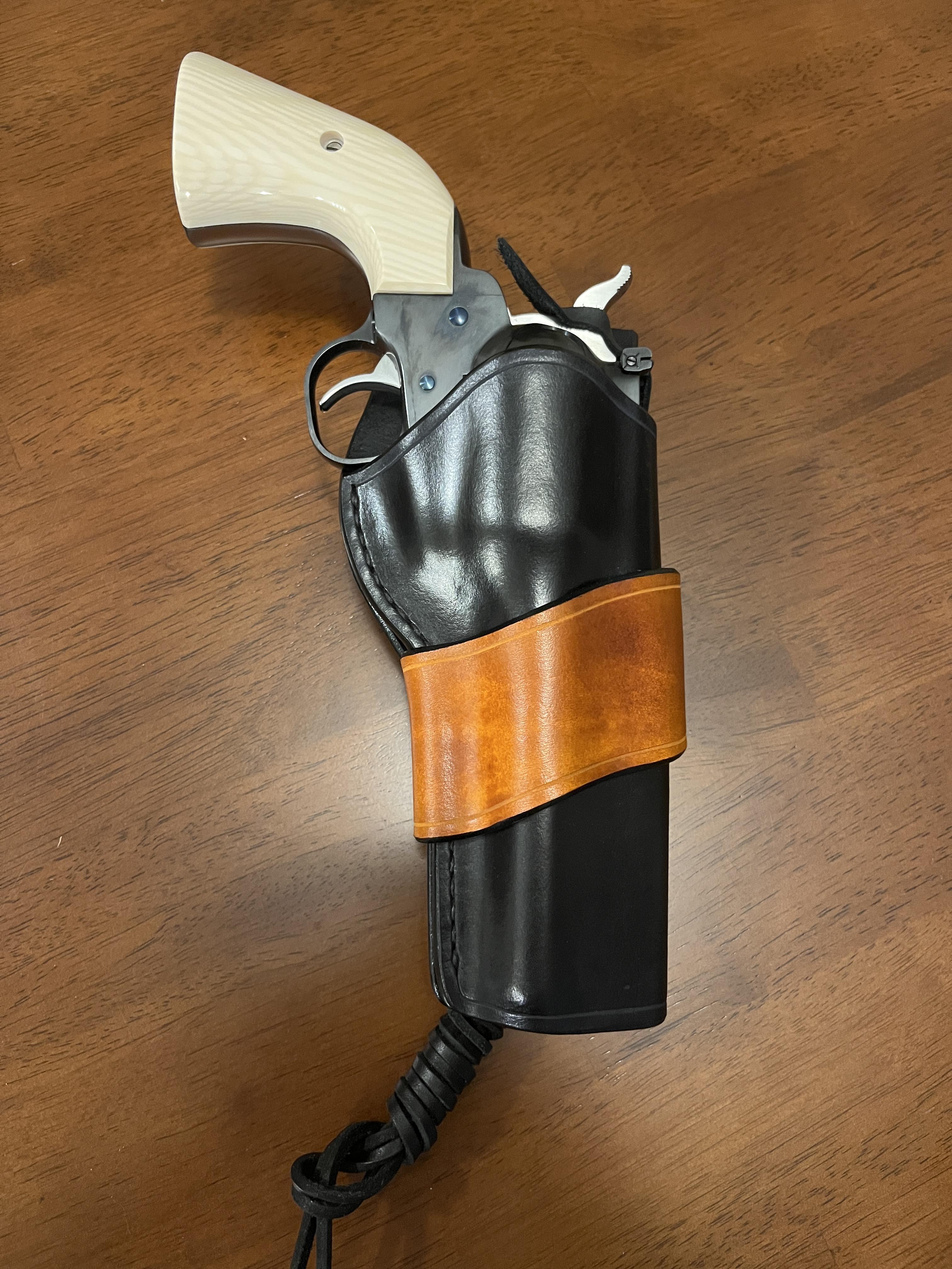

Hi folks, A year or more back, I posted on here about a pattern I'd created to make leather holsters for my two long-slide Glock pistols. They were thumb snap, cross-draw, which was something I just couldn't buy on the open market, so I had to "roll my own." Had a massive thick headache-inducing welt the same thickness as the Glock trigger guard. Recently, I have been shooting some of my single action revolvers and making holsters for them, but in a strong side, old-west style. And this got me to thinking that I'd like to be able to have one of my long-slide Glocks at "gunfighter" position for long hikes in the woods. Anyway, I adapted my sixgun holster pattern (pic for reference) and made the necessary adjustments to accommodate the Glocks, as well as their red-dot optics. Most importantly, I did away with my massive welt and just used a 1-ply welt, then bent the holster to create ears covering the trigger guard, as I typically seen done on leather Glock holsters. Saved a whole lot of work, for sure! I haven't found the need for any sort of retention strap, as the holsters were wet-molded to the guns and seem pretty secure. At any rate, if they ever loosen up to a point where retention is needed, I can pretty easily retro-fit a strap that would snap to the holster loop, which comes on and off via Chicago screws around back. Just posting these as they're kind of a novelty, but also, I had someone ask me for the pattern for my thumb snap version, so if anyone would like a copy of this pattern, I'm happy to provide—might save you some trial and error. Regards, DeWayne
