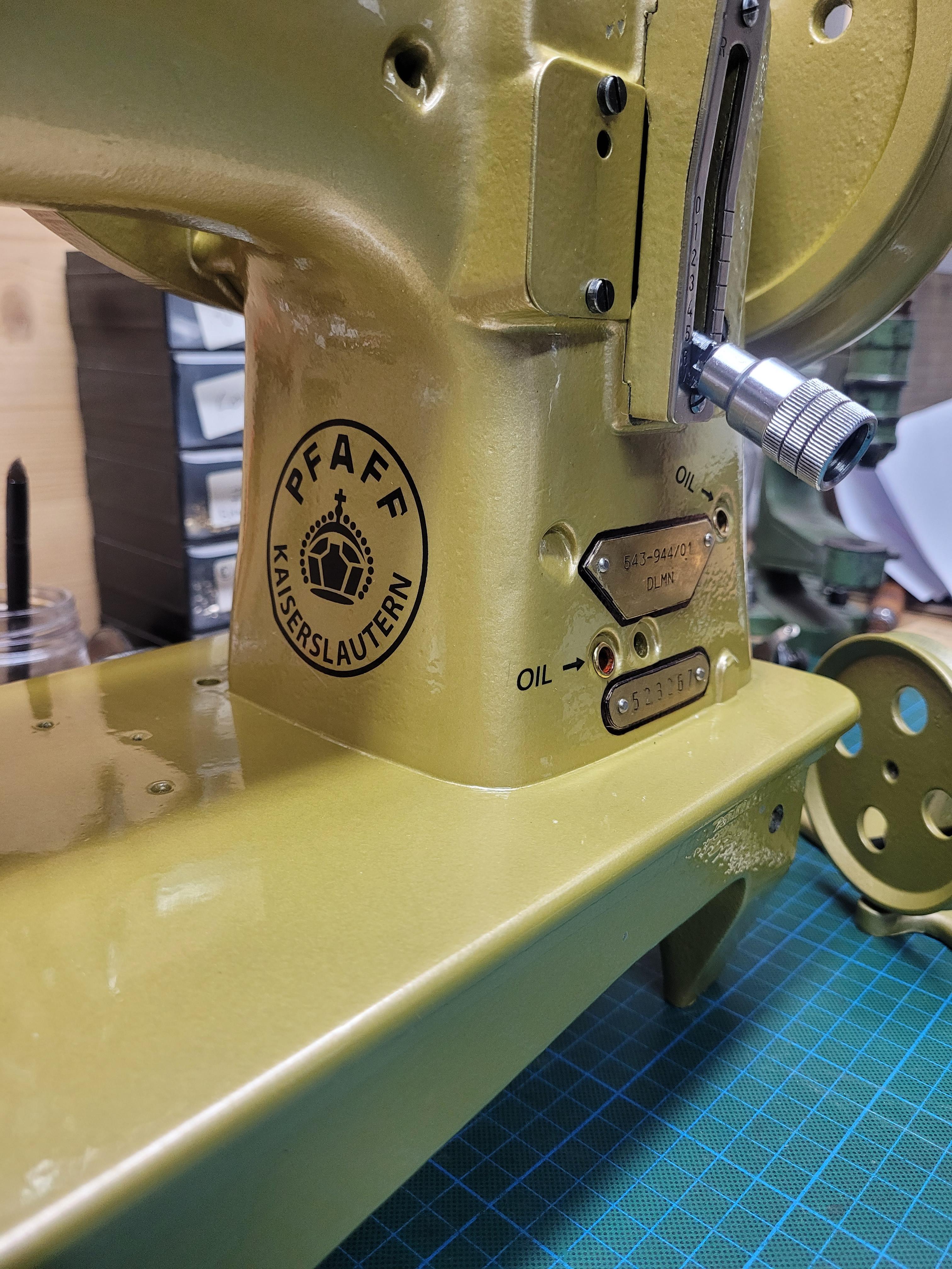

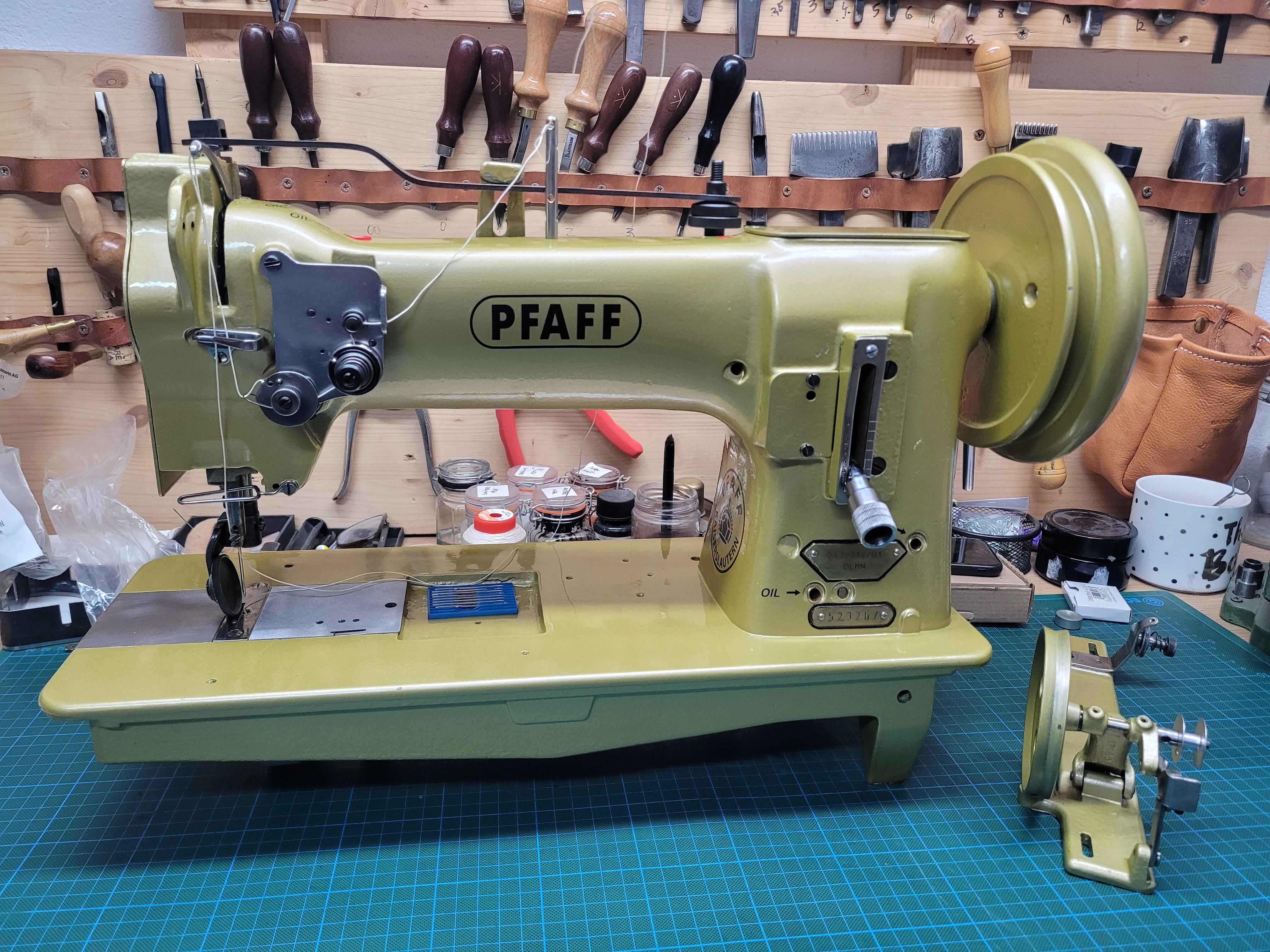

You've done a beautiful restoration on your machine! I have a gently used 545 that I think is a wonderful machine. I'm surprised that you found the parts for your modification, I rarely see anything for Pfaffs. Where did you find the decals?
I ve found it locally in Romania. At a mechanic

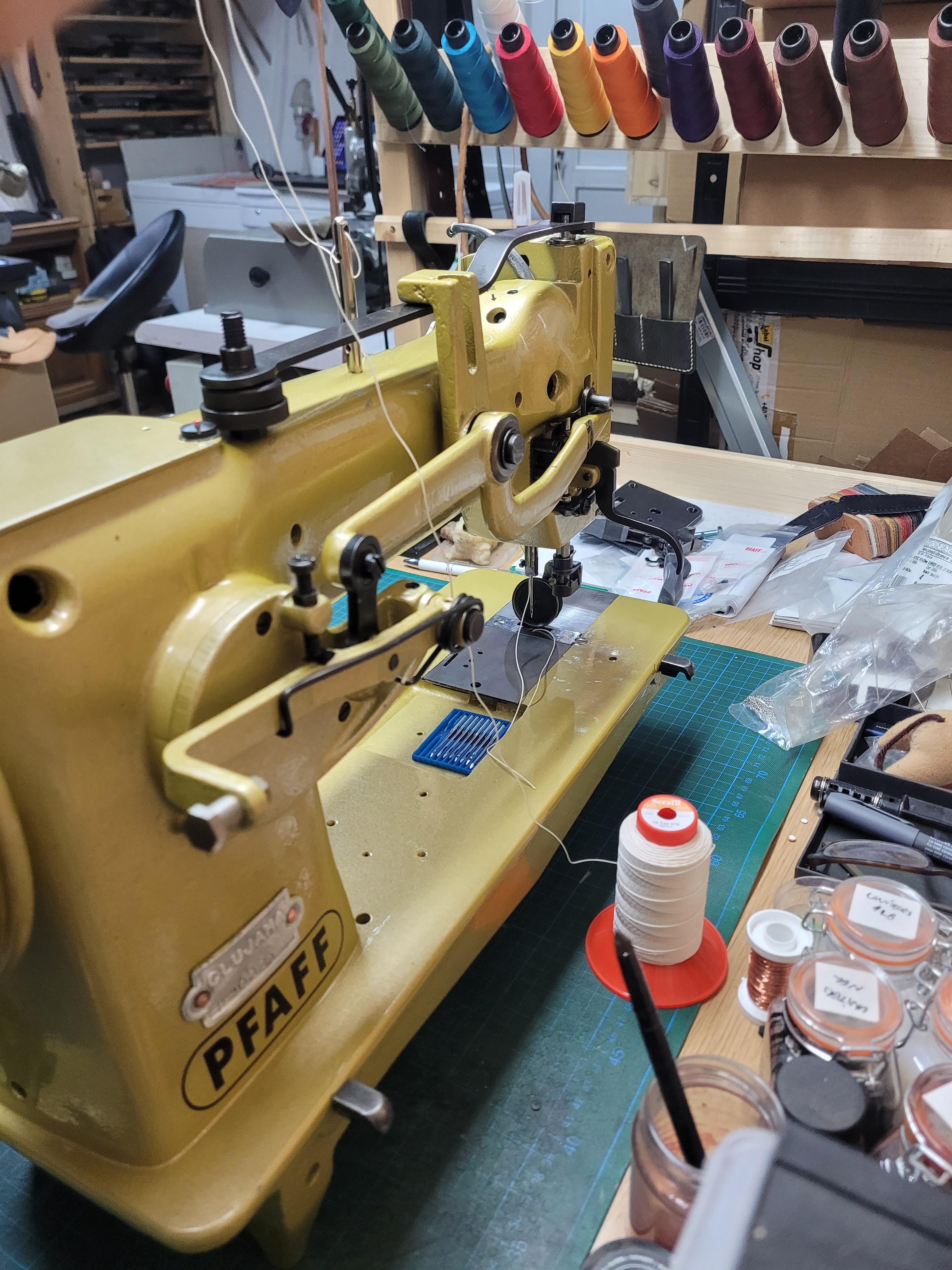

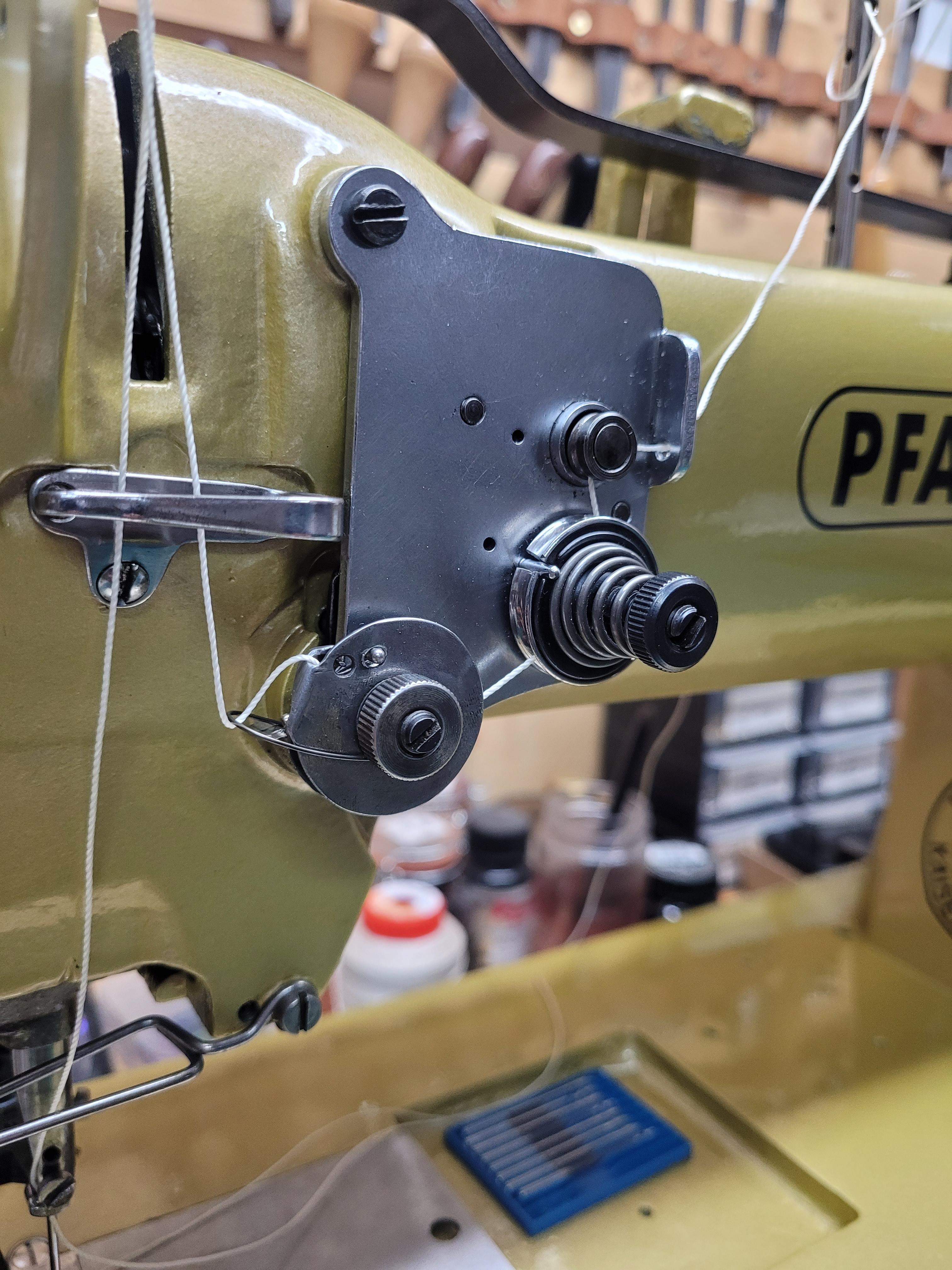

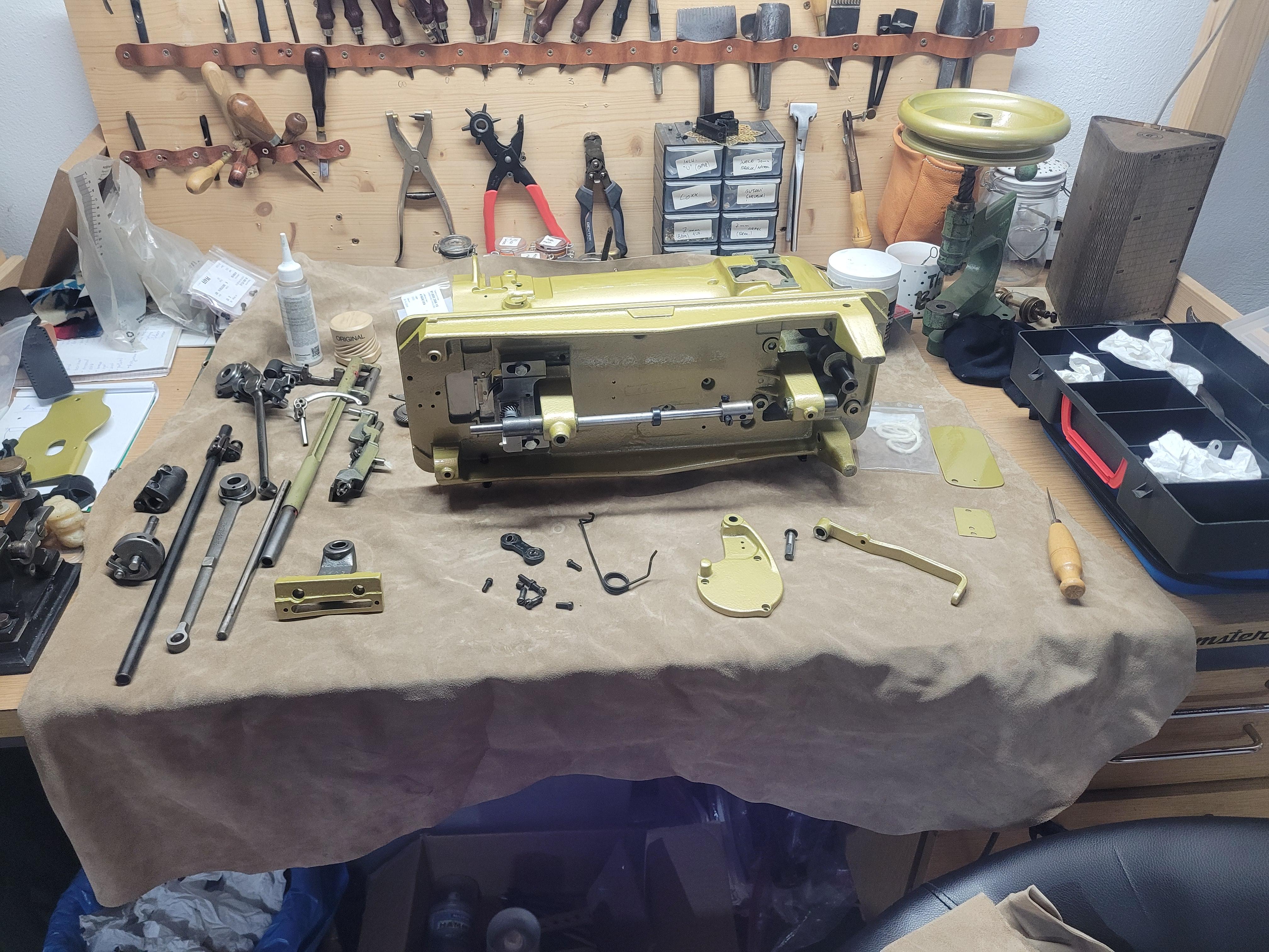

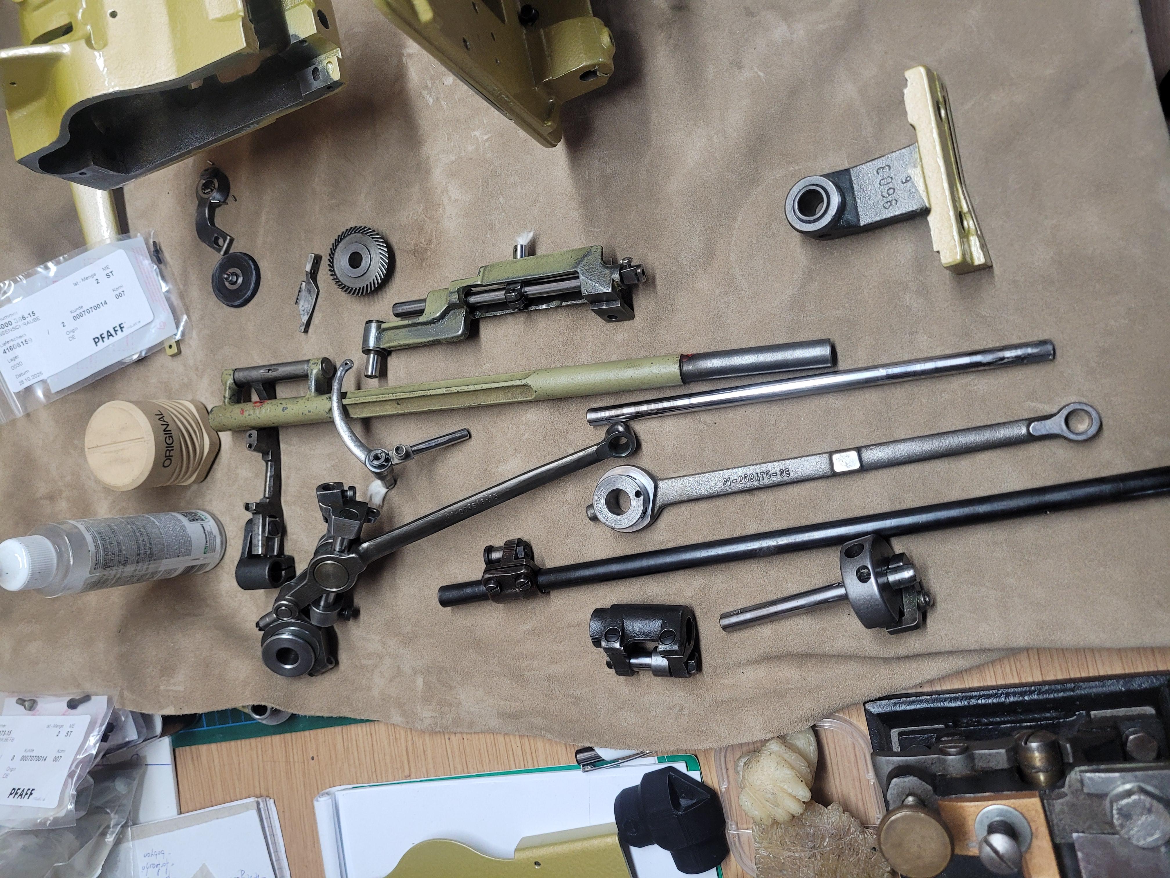

Hi guys, In case anybody needs this info. On my 543 DLMN, I ve added needle feed. I made sure the bushings are there, and then you only need the needle frame rocking shaft and its linkages to the forward movement shaft,parts from a 545 and to increase the slot in the needle plate. My issue was that with the rubber coated feed dog and presser, the machine couldn't feed oily leather. Now it works beautifully. https://youtube.com/shorts/rnloVTpOTMM?si=CJgy8PEpiT6QMeQO Probably same scenario can be applied to Pfaff 143. The machine was completely rebuilt by me at the beginning and it is stitching beautifully my belts and notebook covers. It can handle thick threads, upper and bobbin, compared to my 169 Adler. Pics are from the rebuild. The parts for the needle feed were added after everything was assembled. A bit of planning needed but it went ok! Cheers, M.
