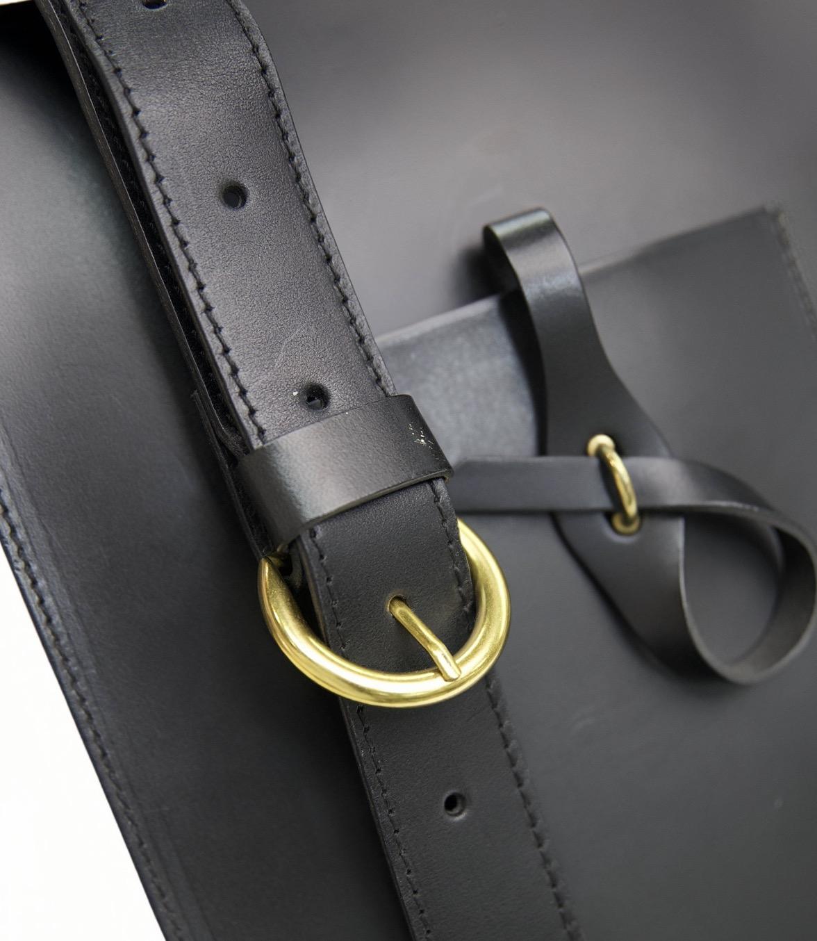

It's very beautiful. The edges of the leather could be made even more attractive. You can take a look at our product's bag edge sealing technology - njipens-bag.com
