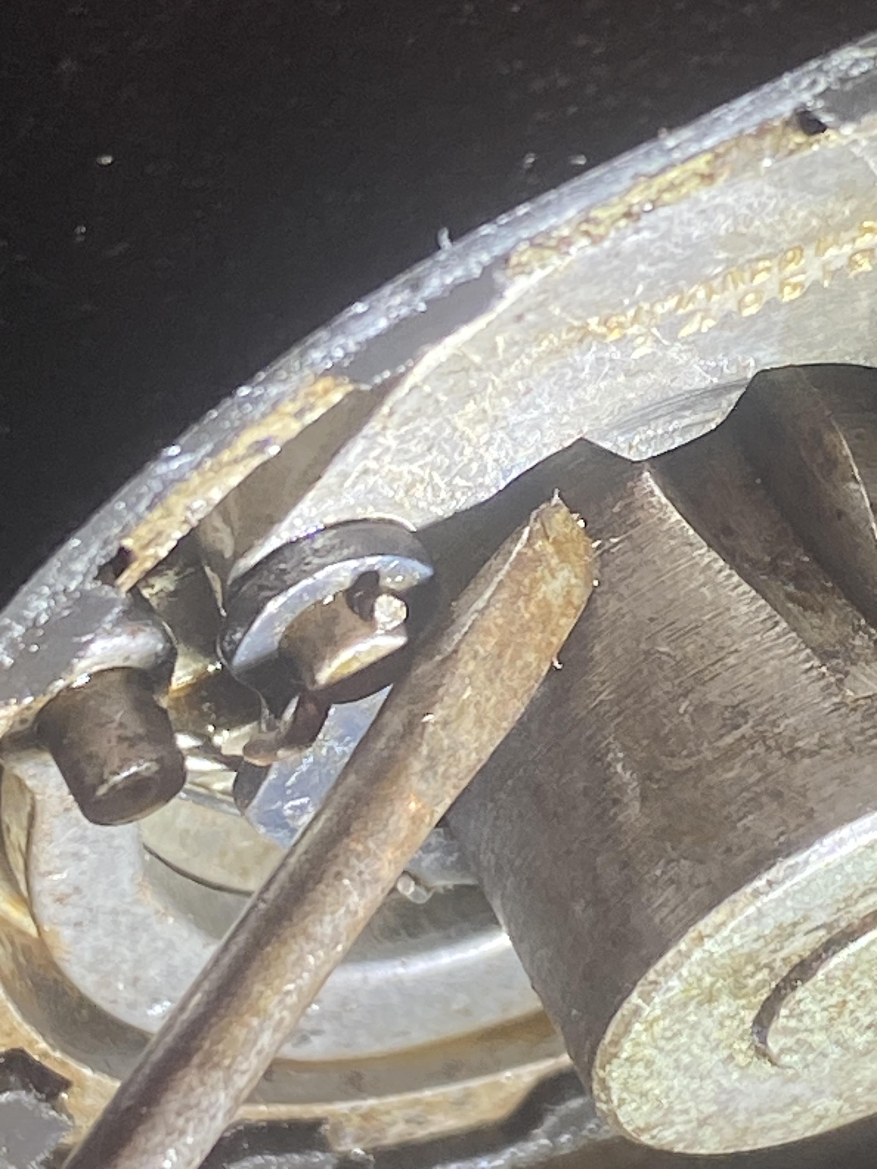

  2. Photo 2 I believe that there should be a space between the outer wall and the plate but correct me if I am wrong. It seems stuck up there.

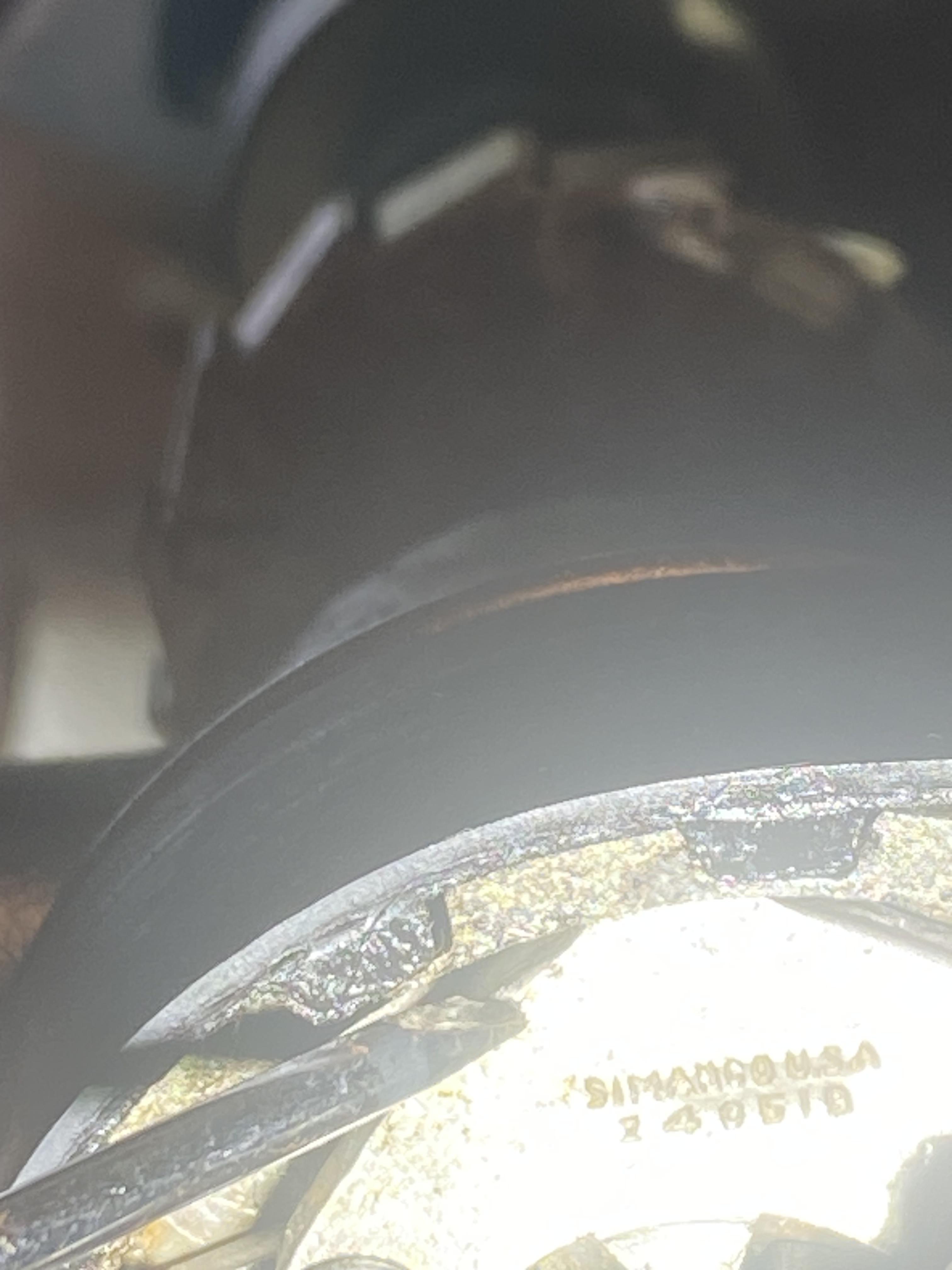

  3. Photo 1 …..pointing to slot….its not lining up.
  4. We pushed button. It is in gear. Shaft is moving perfectly but we still have the problem in the video. The little piece ( don’t know what it is called) is not going into the slot the way it is suppose to. It is just on the edge of it.
  5. Thank you cowboy Bob and kgg. We did engage the button. That was the first thing the repair guy did. Fixed the button and engaged it. Then he went to clutch area and that is when everything stopped. He fixed and tweaked everything else but did not feel comfortable taking apart clutch. We have been oiling for two days. Here is where we are at. Thank you for any help.

  8. Hi Bob This is Ron Nancy’s husband. Thank you for replying. I did watch the same video Singer Safety Clutch above several times. Here is the problem I’m still having. Any help will keep me out of the dog house 😂

  12. It's not rusted,don't take it apart! Just re-engage the safety clutch & you'll be sewing again.

  25. Here is a decent video on how the safety clutch works. ( If your machine will not reengage as @CowboyBob has suggested due to parts being seized I would suggest removing it and soaking it in diesel for a day or so then oiling it. If it still will not work either replace it or as a very last resort tack weld it in place. If you tack weld it in place you will not have a safety and if you jam the machine up you probably or more then likely going to damage / destroy other internal spots. kgg
