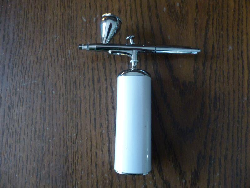

Here's what I ended up with on the cordless compressor. @dikmanit sounds like your compressor is like mine. It had some kind of white thread locker material as well, but I was able to twist it loose. One mine, the top shell of the compressor unthreads, so if you need to put some heat on the fitting, you can do so without effecting the plastic parts inside. One mine, both ends of the top fitting were odd-ball, so I bought a Badger (M5) male to Paasche female adapter, as the Paasche thread was a little smaller than what was on top of the compressor fitting. I used my lathe to turn down the compressor fittings threads and re-thread them to match the Paasche adapter (about .256"x40tpi). It's not the tightest fit, but the rubber o-ring that comes with the adapter sealed it. The compressor fitting's inside diameter was a little too big to cut it all the way down to a Badger thread and avoid the adapter. It works! Time to pass it on to the kiddo.
