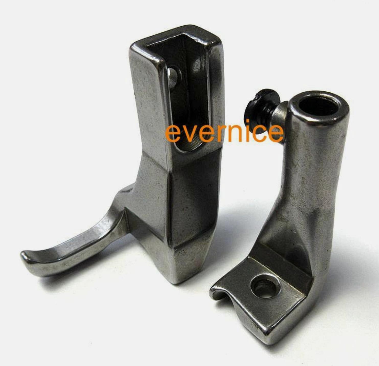

Lots of those specialized presser feet have been around for over a century. There's a reason they endure. A zipper foot definitely lets a person stitch extremely close. In the case of a zipper foot (say on a domestic machine especially) you're well off to pair it with a needle plate that has a close fitting needle hole instead of a zig zag plate. The larger needle hole can let your sewn goods push through and mess up your stitch. You'll run into a lot of these little issues as you expand your sewing skills.
That’s a good point. What about different hopper feet? Would a zipper foot make zippers easier to stitch? sorry for all the questions.
