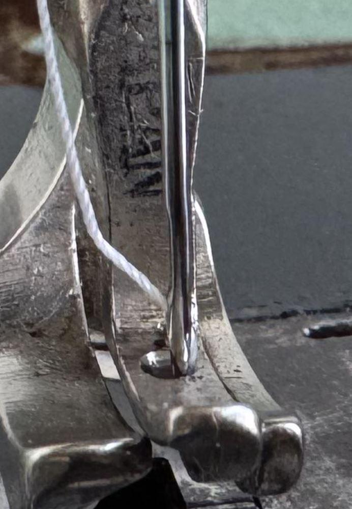

  14. @kgg, well spotted! I wonder if turning the needle will better center it in the hole? I recently was playing with a domestic machine, having a problem shredding the top thread. Turned out the needle was off center and backwards, shredding the non groove side against the needle plate.

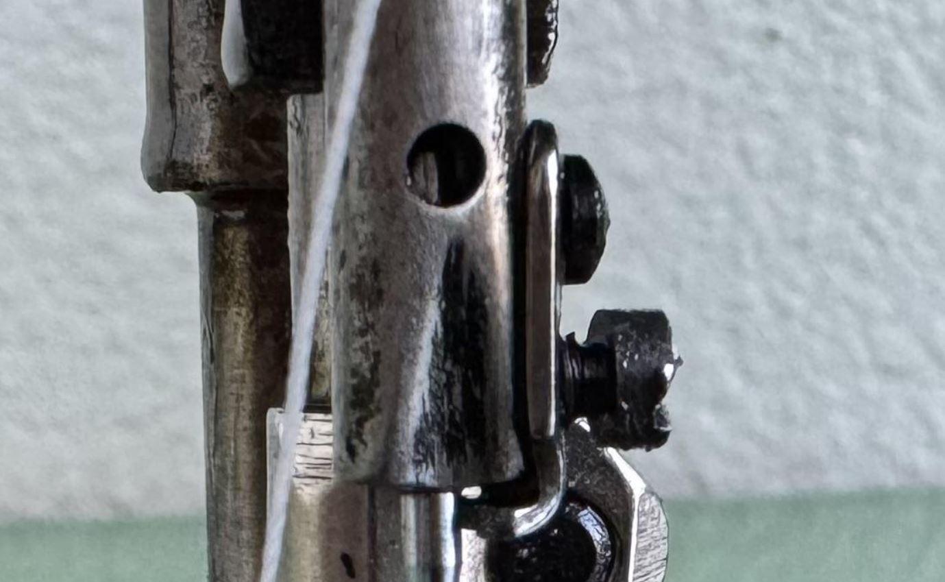

  15. A couple of problems I found with your threading of the top thread. Without these corrected you will never get good stitching. 1. The needle is installed backwards. 2. Needle bar thread guide is missing. kgg

    Laser Cutter and Engraver

  20. When you turn the work, first bury the needle and raise it up a quarter inch. Raise the presser foot and turn the material. This allows the hook to catch the bobbin thread and prevent skipped stitches. Same thing with turning a corner. To begin a stitch line, start about 3 stitches down the line and sew back to where you wanted to start. Turn around and go in the direction you wanted to in the first place. At the end, you can just turn around and sew back 3 stitches. If you begin at the start, sew 3 ahead, then turn around and sew back to the beginning and THEN turn around yet again, sewing in the "right" direction, you have gone over the first 3 stitches 3 times! Way too many stitches in leather. Practice, practice, practice ...
