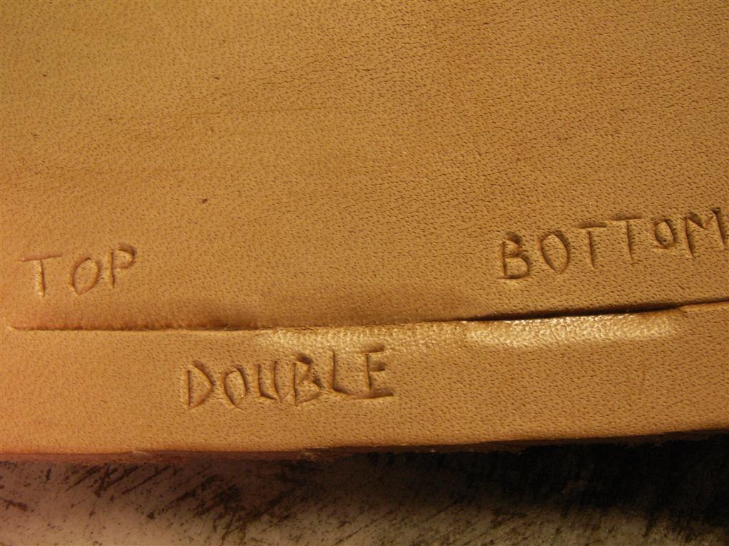

[quote I don't understand the double beveling you mentioned where the feet hit the ground??? Here is a picture to try and show what I meant by double beveling. It is kind of hard to explain, but you will get a different effect depending on which side of the line you bevel. If you bevel the bottom of the line, it may look like the foot is above the ground, floating instead of standing on it. If you bevel the top of the line, it will look like the foot is in the ground, as if it were standing in soft dirt, sand or mud. If you double bevel, it should make it look like the foot is touching the ground. I also took a couple pictures of the home made wooden background tools and the impressions they make. They really work nice on a bigger picture where you have a lot of background to cover. And finally, I decided that if I was going to try and tell you how to carve an elephant, maybe I should try one myself. I looked in the FIgure Carving Finesse book that I mentioned before and Al had several elephants in there. I picked one and carved it. I took a series of pictures as I was going. I will send thess off to Johanna and maybe she can post them for me. I did most of the work on the elephant I carved with just a modeling tool I think that it is probably the most important tool you can have if you are doing figures, and also is pretty important with any other carving. It has so many uses and one of the biggest is to smooth everything out. I think you will find that your second elephant will be a lot easier, and you will be able to add more detail as you go. Figure carving just takes practice, and I think that you will do well at it. Clay

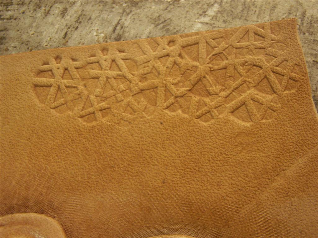

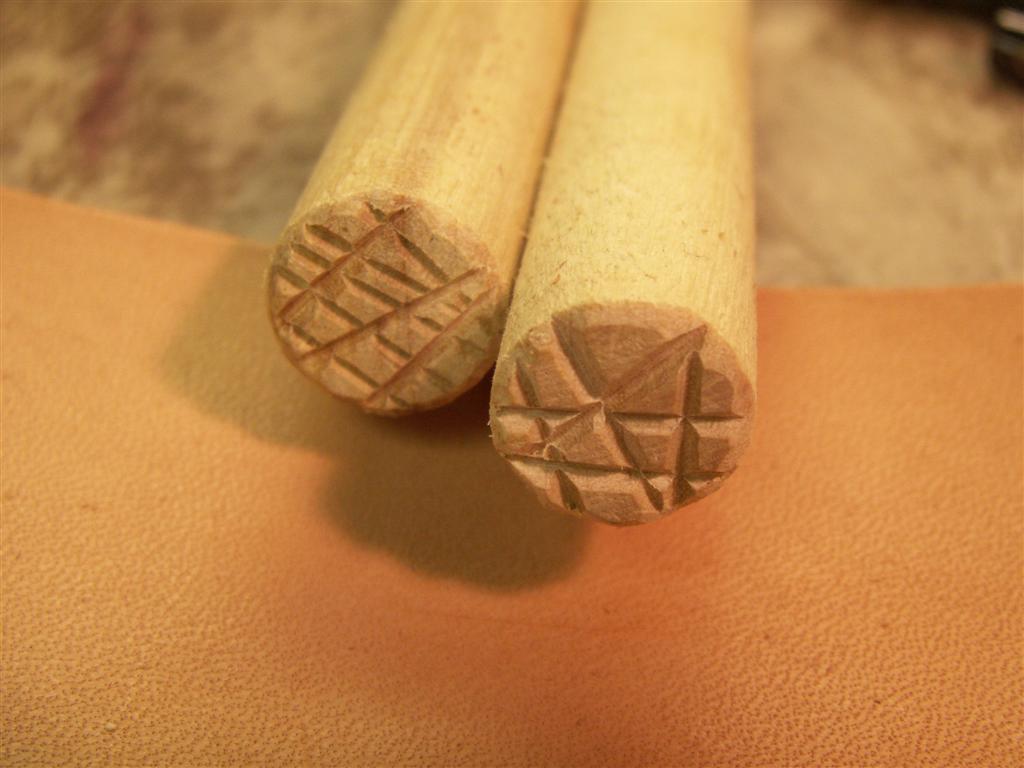

My first thoughts would be to try some matting tools. Tandy has some numbered M655, M656, M657 or Hidecrafter has similar tools numbered E281, E282, and E283. These might give a texture similar to the elephant skin. My next thought was to see if Jan Schoonover ever did an elephant. He did, and you can see it here. http://www.sculpturedleather.com/site/4599...age/138654/site His pose is different so I don't know if that will help you out a lot. In one of the classes that I took with him, he showed us how to make simple background tools out of wooden dowels. He just takes a piece of wooden dowel about 3 inches long and cuts random lines in the end with a small file. This would be a fairly inexpensive way to make your own texture tool and if you don't like the impression it makes, just cut it shorter and try again. I don't think I would cut the texture in with a knife. One other thing you could try is just to "draw" the texture in with a modeling tool. Those are some ideas, someone else will probably have some others that you could try. Clay

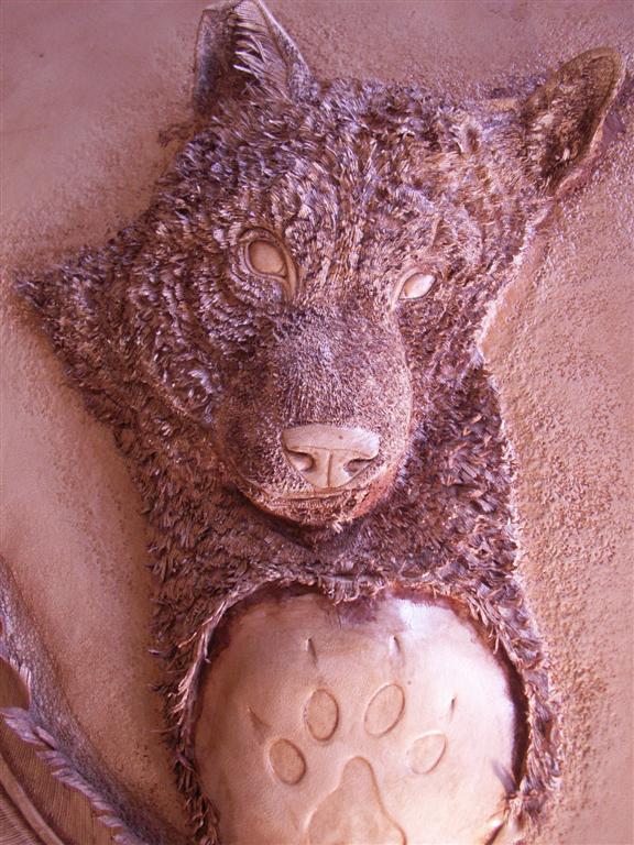

I started quite a few of these pictures a couple weeks ago when it was too cold to work outside. Here is Robb's wolf puppy, ready to get painted. Clay
