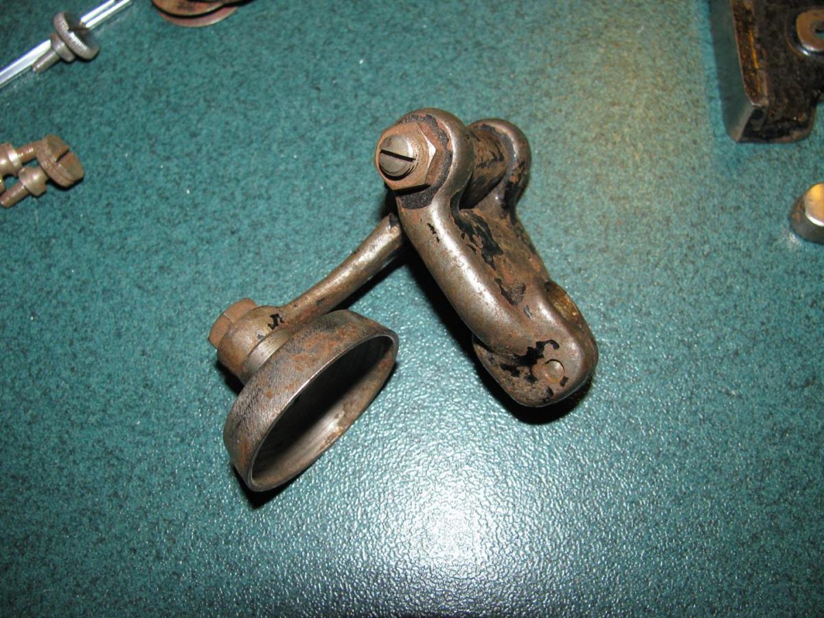

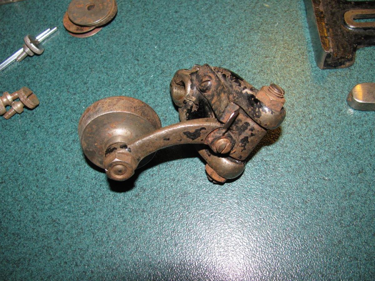

  4. That parts belongs to the 2-piece bobbin winder - see picture. if you don´t have the main part I may have one if you are interested... will look for it later today.
