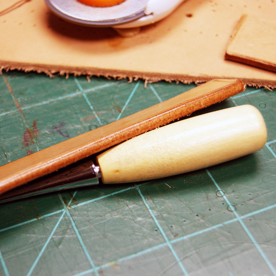

Yes the last picture you posted is designed to be connected to a soldering iron. I was simply saying that i choose not to get it as the wood burnisher I already had works well so I just didn't bother. In my photos, the first one done with a wood burnisher connected to a dremel. The 2nd photo was to show JanC that I was referring to Edge Paint, not Edge Coat - done with the heated brass tip connected to a soldering iron, and the 3rd photo was done with the heated brass tip connected to a soldiering iron on regular vegtan. (The last photo IMO did not turn out too well) I have only used it on thin leathers that are too soft to burnish normally. (Bag leather using the edge paint) I do have some Chromexcel and Oil tanned leather that I can try it on, as soon as I get a minute I will try to get some pics of those. Karina
I add the lining to the bag before assembly. This way you can eliminate any visible raw edges. The lining is usually the same size as the bag, and I do not glue the lining to the leather. Search YouTube for Dopp Kit, Toiletry bag, or box makeup bags. Although they are made of fabric, the process for making it with leather is the same. Also you can check out Craftsy.com, there is a free pdf that tells you how to make it. Search for "No Guts Boxie Pouch", again it is made of fabric but it works with leather as well. Karina
That last link you posted I was thinking about picking that set up some time ago but I ended up getting a wood slicker from leatherburnishers and just didn't bother, although I am sure if chucked in a Dremel it would work the same as the wood burnisher I have. I did a test today on a scrap piece of vegtan. (I want to say upfront that I had no idea what the heck I was doing but here is the process) I first use liquid glycerin and a wood slicker on the edge to lay down the fibers. Then I went over it with beeswax and use the hot tool to melt in the beeswax. I am thinking I had the temp too high because it appears to have darkened the leather quite a bit. Maybe if I would have applied a finish on top it would have turned out better, but......... Here are some pics: 1. The first pic is an edge done the Bob Parks way. 2. The second pic is black edge paint that has been hot glazed. (can't really tell in the photo but up close it looks just like a plastic coating of some sort. (Not a fan of that look) 3. The third pic is the edge I did with beeswax and the hot tool. I am sure with more testing I can get this method to work, and as I stated before I had no idea how this should have been done, but for now I will just stick with Parks method. Karina
No I am referring to Edge Paint not Edge Coat. I use a product from Japan that I am told is similar to Fenice Edge Paint. You paint it on then heat seal it. Here is a video that shows the process of applying the edge paint. I don't have the machine she is using I just use a fine tip brush to apply. https://www.youtube.com/watch?v=k3-XM-jPOmk Karina
I purchased this set solely to use to add decorative lines to my work. I did however use the larger one on a leather wallet I made that the edges would otherwise be difficult to burnish along with edge paint, then heat sealed it. I worked great, but I happen to not like that look as it looks "plasticky" to me, although many high end brands use that method. I have never done it on regular veg tan as I follow the Bob Parks method, but I don't see why it wouldn't work. Karina
