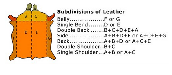

Looking For The Best Leather For Belts That I Can Dye Myself!
veedub3 replied to Austyn's topic in All About Leather
That is not a single shoulder but a single bend which is much larger than the single shoulder. Even larger than the double shoulder. For reference D or E vesus B and C. To the poster - I purchased that same one and it worked great. I got one a year ago but I think the price was $119 then. It was a very clean piece with no range marks, fat wrinkles, bug bites, or nicks and the backside was very smooth. Karina
