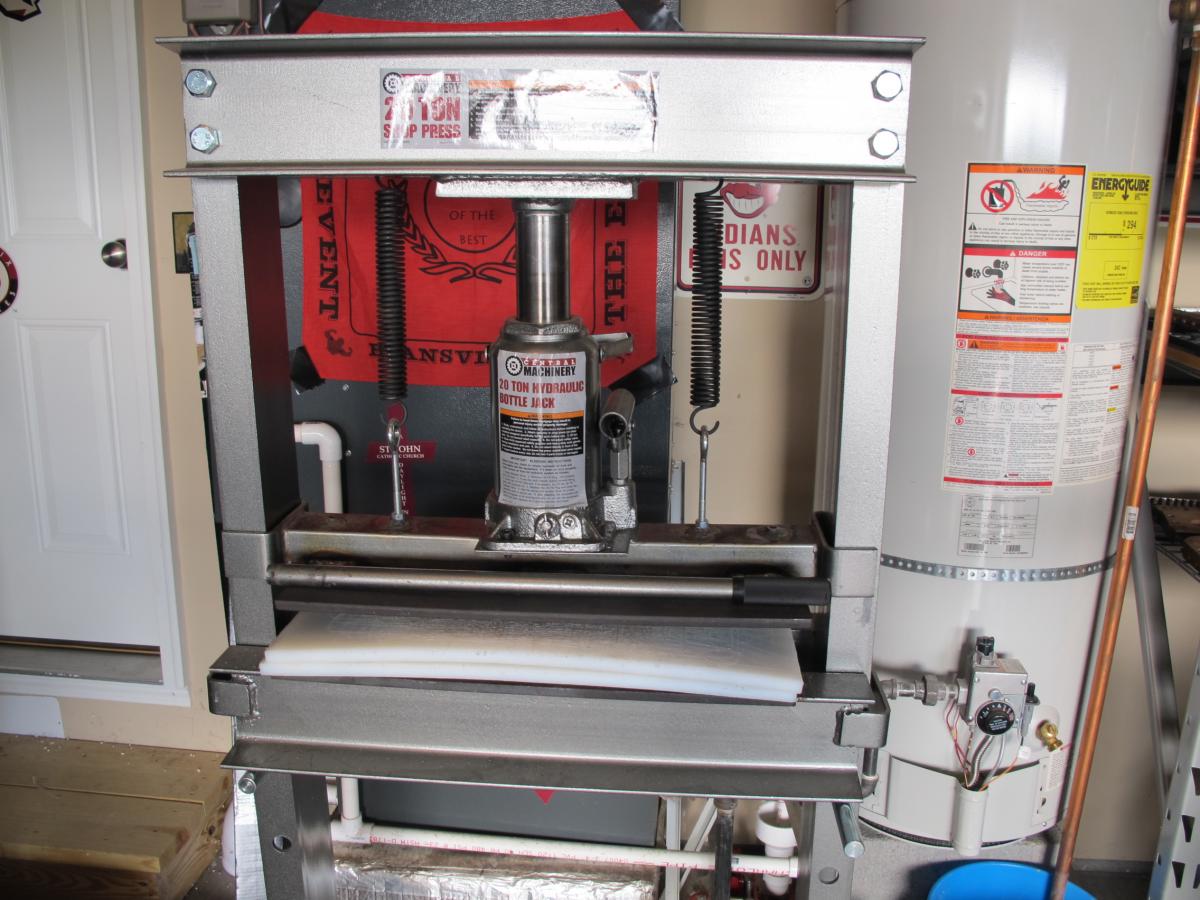

Up for sale is my 20 ton hydraulic press that I modified to work as a clicker press. The press has a 3/8" welded steel plate under the top cross bar and above the bottom cross bar. I upgraded to a larger press due to the volume of work I have been receiving. The press works great, I'm just trying to clear up some space in my small shop. If your interested in the press, I am located in Evansville, IN which is in the southern part of Indiana just above Kentucky.

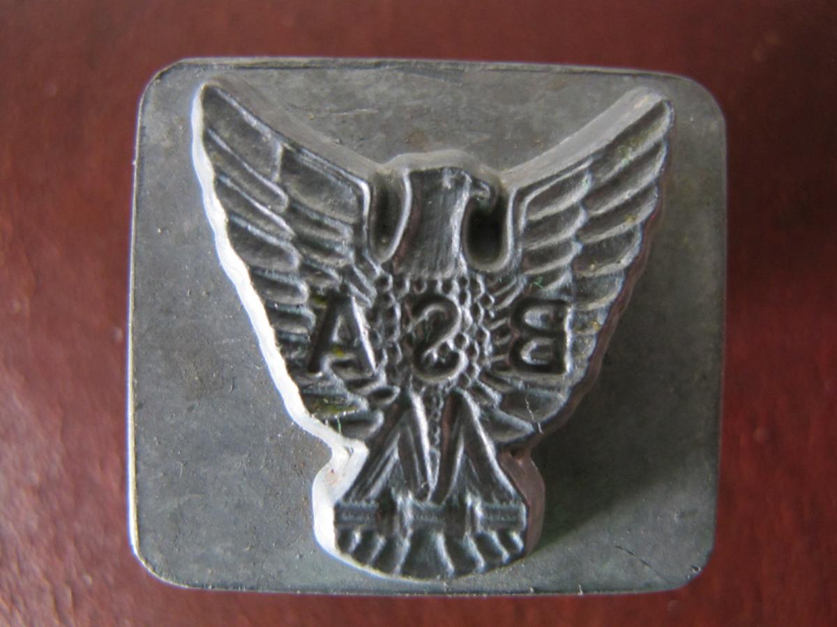

Mid 90's tandy and midas put out a few tiger stamps. The number on this one is 8505 and they pop up sometimes on ebay.
there is loads of information on this site about mallet/clicker dies. I have had good experience with Texas custom dies in the past. One thing you might consider is that your die cost will go up $20 to $30 for the added handle compared to a clicker die. I made my first press for around $150 using a 20 ton harbor freight shop press (the press was on sale and I welded my own plates/reinforcements). So if you plan on having numerous dies made, a press might be something worth looking into before you invest your money into mallet dies. link for press details http://leatherworker.net/forum/index.php?showtopic=35165

I put a couple of the harder to find Boy Scout Craftool stamps up on an ebay auction. Ive seen topics on trying to find the wood badge stamps on this forum before. http://www.ebay.com/itm/Rare-Craftool-Co-USA-BSA-Boy-Scouts-Adult-Leadership-Wood-Badge-Logo-8507-/131495763572?pt=LH_DefaultDomain_0&hash=item1e9dc21e74 http://www.ebay.com/itm/Rare-Craftool-Co-USA-BSA-Boy-Scouts-OA-Order-Arrow-Chief-Logo-8508-/161684016429?pt=LH_DefaultDomain_0&hash=item25a51e4d2d

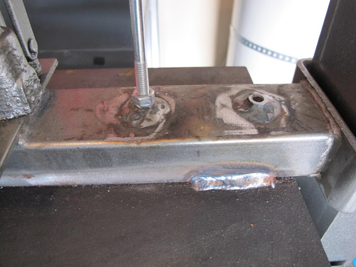

bylinesupplyco, I cut the ram off and welded a 1/2" 10 x 20 Steel plate to the top and bottom cross bar. I welded some nuts to the top cross bar/attached two eyelet bolts and drilled/added two bolts to the top of the frame to add two extra springs to the top cross arm to help support the added weight. It has worked wonderfully for me over the past two years, but it has it limits. Unless your working with scraps you have to precut a lot of your leather to get it to fit under the press, so you will have quite a bit more waste compared to a traditional clicker press. As far as the minimal investment you can't beat it, I picked my press up for $150 on sale at harbor freight. Too bad your so far away, I finally decided to purchase the weaver 8 ton press due to the volume of work I have been doing lately and will be selling my press shortly.
