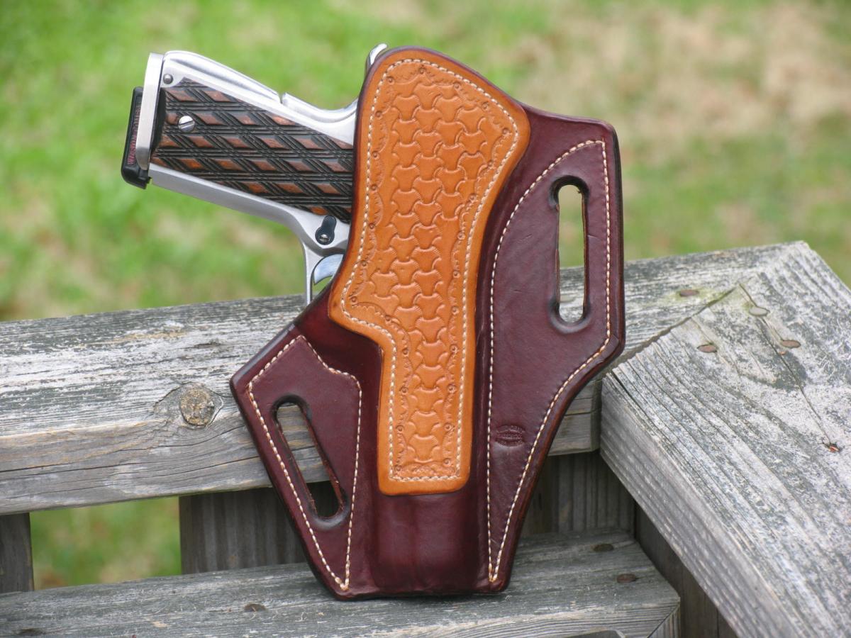

New Slim Holster
Red Cent replied to mike6642's topic in Gun Holsters, Rifle Slings and Knife Sheathes
The straight hang and anything else that points the barrel forward makes it difficult to expose the grip properly and keep the grip frames close to the body. It comes to manipulating the belt attachments whether they are slots or loops. This looks to be bulky but it hides very well under almost any cover garment and protrudes no more than any pancake. -
+ on the quilting squares (courtesy of my wife) and the 90 degree squares. Making a square or a rectangle "square". You square both of the perpendicular sides and then add them together. Then you take the sum of the two numbers and take the square root of that number. A 6" square will have a diagonal measurement of 8.48528137". 6 X 6 = 36. 36 + 36 = 72. The square root of 72 is 8.48528137". Been a long time for that to be remembered. And I did not make good grades in math
Mike, not questioning the tension or security of the holster. It will become really loose as time goes by unless you do another closer stitch line. The "setting too high" refers to where the center of balance is in relation to the belt. With a very light handgun, it would work and it probably works well now. " you can draw gun without telegrahing your draw " Now you done it . As an old gun guy, I am interested in that statement.
I am a little confused about the holster. The fit is going to get loose but it is a nice design. I believe it is a left handed OWB holster. Two things; the holster is riding a little high on the belt. It might work if it was a pancake or an Avenger style. The holster will not remain close to the body. Or are the leather straps attached at the top of the holster?
