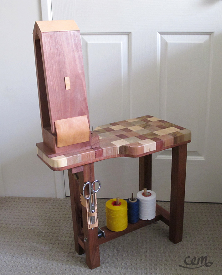

After finally having enough of sewing on that woeful Tandy pony for the last few years I decided to make my own stitching horse. I'm definitely not a wood worker by any means thinking yeah it will be alright to cut and sand wood in my leather work room ha ha ha big mistake that was, took two days to clean all the dust up. Anyhow a little about the horse it's made with West Australian Jarrah (red looking wood) and Tasmanian woods (Myrtle,Huen Pine,Blackwood,Leatherwood,Celery Top Pine and Sassafras) for the top checker look. It's a hybrid of Al Stohlman design and the one with the rotating jaws on Cascity,I made it with straight legs though as it needs to fit in a certain spot in my room. The rotating jaws work from brass tube going through a skate bearing that is recessed into the seat it has a nut at the top of the wood block that can be tightened to stop it rotating. Also made another couple of modifications with the scissor and thread holders. I left a bare space at the front in case I wanted to add any more tool holders at a later date The Tasmanian wood is kind of special to me as I was with my sister when she picked it out from the mill in Tasmania when we did a trip there in 2007 with all the girls of my family. My sister on the other hand was a brilliant wood worker and had planned to make some cool stuff with it. Sadly she didn't get to and it was the last trip I got to do with her as she passed away from cancer in 2010. I wasn't quite sure what to do with the wood as there wasn't a lot there and with my limited skills but I wanted to tackle something myself with it, I think she would of liked it's end use though as she was the one who also got me interested in leatherwork. Anyway here it is I hope it also might give some additional ideas for those who want to tackle making their own stiching horse.

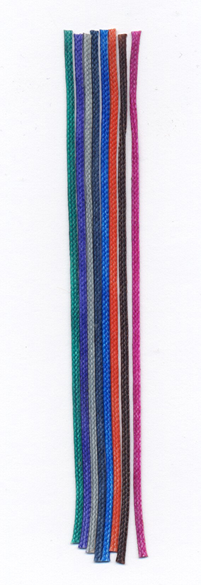

Hi minimal Oz it's set out in points 1-7 of how I do it and underneath that is the dye and pigment I use, you can buy Fiebings and Art Spectrum pigment ink in Australia. Fiebings from Birdsall and any art supply store should have the Art Spectrum pigment ink. The Craftsha grey dye was bought from goodsjapan I only use that as it's a premixed grey dye. No it's not dyeing the wax if it was that it would rub off by the time I got through the 5ft of thread which it doesn't also if you pinch tiger thread together the single threads separate and what I dye looks no different than what the dyed thread from Julius Koch looks like. I believe it works due to the small surface area of the thread I doubt very much that it would work on wider polyester stuff.
Sorry it’s taken a little while to get back to you been flat out this week trying to get some stuff done. Anyhow here you go these are just small test pieces I usually do these before dyeing whole sewing strands of about 5ft From left to right emerald green, purple, mid grey, navy blue, royal blue, orange, mahogany & magenta in 1.2mm size Some of these colours are available from Abbey but not in the 1.2mm size which I use the most, the original thread colour was white. Turquoise and gold in 1mm size These two colours aren't available at all in Tiger, original thread colour was silver grey as I had run out of white but its light enough not to really make a difference. They might look a bit uneven but they aren't in person, the unevenness is due to my scanner Now the process to do it isn't hard but can be messy and is more time consuming than dyeing linen. 1. Get a fairly longish plastic container pour the colour dye you want into it. 2. Make large loops of your thread (dependant on length of your container) 3. Place into dye bath and leave a few minutes 4. Remove thread from dye bath place on paper towel and let dry for ten minutes. 5. Wearing disposable gloves unravel the thread and run your fingers down it you will notice that a bit of wax residue comes off this is normal and is what you want to happen, you will notice that the colour isn't even at the moment so with that. 6. Re loop the thread and place back into dye bath for another five minutes then repeat first part of step 4 then leave to dry for at least an hour. 7. Unravel thread and run your fingers down it again to redistribute and seal the wax. If it is still uneven you may need to do another dip some colours do take better than others this is mostly a trial and error thing so make sure you write notes down if you want to replicate the same colour. I don't use the thread until the next day just to make sure it's completely dry. Now for what dye or pigment to use, the mahogany shown above is Fiebings oil dye, the navy blue is Fiebings water based the mid grey is Craftsha water based and the rest are Art Spectrum pigment ink which is also water based. Now for the important part with the water based stuff you need to add a bit of methylated spirits ( US = denatured alcohol) to get the colours to absorb into the thread otherwise it won't work. The Art Spectrum pigment ink is an Australian brand so I'm not sure if it is available overseas but I expect FW ink would work as well. I plan on doing a test with that but it won't be for a little a while as I have a bit of work to get through first. I mostly use the Art Spectrum ink as they are more lightfast compared to the leather dyes, I put an example of the gold on a window sill for six months and it has probably dropped only a quarter shade whereas the leather dye was three quarters gone. I would love to be able to get some of these colours directly from Abbey or Julius Koch and although I use a fair bit of thread it's not enough to get custom colours made up. Like I said before its not hard just time consuming, if you’re still interested let me know and I will do up and take some photos of some new sewing examples. As I can’t show what I have at the moment as they have personal details on them and I don’t have the clearance to show them at the moment. Hope this helps if you want to have a go at it yourself
