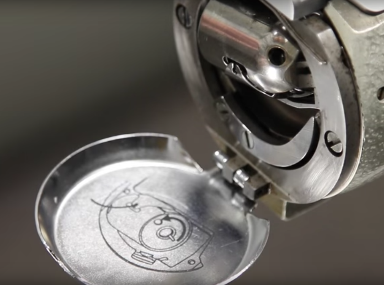

Nice work! I'm a big fan of putting instructions and information right where you need it. My label maker gets lots of use. One of the first things I do when I start working on a new machine is make a needle system and size range label and stick it on the machine. The other thing I often need a reminder of is which way to insert the bobbin. I made a graphic and lasered it right on the inside of my bobbin cover of my Adler 205 (a clear sticker would work just as well in that spot, but I have access to a CNC laser and I really wanted to try out the metal marking fluid). I think I'll start lasering bobbin threading graphics onto the hook slide cover plates of my flatbed machines. The advantage of laser etching bare metal is that it doesn't wear off.
