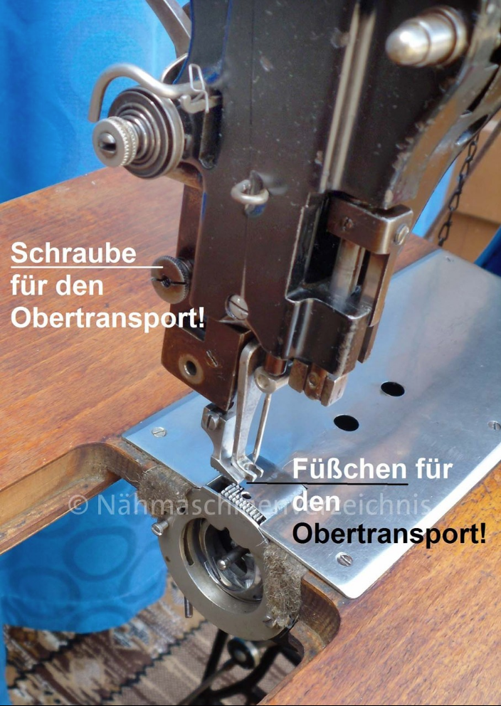

What is this old German cyclinder machine a clone of?
Uwe replied to alexitbe's topic in Leather Sewing Machines
It appears to be a Köhler 17-61 based on the info and pictures on this web page: http://www.naehmaschinenverzeichnis.de/verzeichnis-der-naehmaschinen/altenburg-köhler-textima/ The machine does have an optional walking foot mechanism that can be engaged and disengaged. That shaft across the back is there for that reason. Installing the walking foot and moving the screw indicated in the picture from the lower to upper position enables the walking foot. The walking foot installs on the front presser bar, but sits behind the needle. It's an unusual design and finding these specialty presser feet may be hard or impossible. Unless your machine comes with a box full of parts and feet, it may not be a practical candidate. Here's a picture with the optional walking foot installed: -
