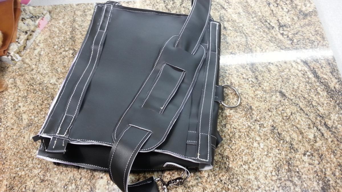

Hahahah... normally, I'm a sucker for staring at the stitching to see if there is something I can learn from to improve my own work. This time, I was so entranced with the imagery in the leather that I didn't even realize it was stitched until I read the comments! Great work, and the stitching is pretty dang good too, so no frettin there! thanks for sharing! YinTx- 11 replies

Those are great bags, but I have a question: by edge work, do you mean stitching? It looks like I see holes for sewing, but no thread... or do you not plan to stitch? Or am I just not seeing it? The three tone dye is a cool effect, and I like the image tooled in the center too! YinTx
