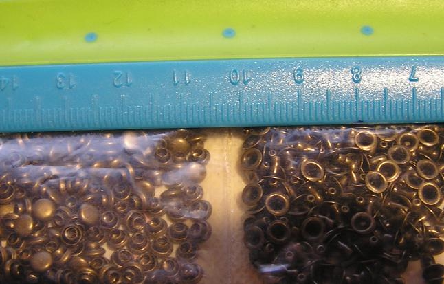

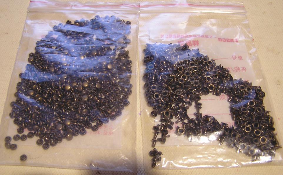

  17. I bought those by mistake and have no use for them (until I will start making wallets or clutches, which is beyond horizon). These were made by Ningbo Pasco in China and their p/n is PIN-047 4MM. All 500 for $10. My wild guesstimate is that they will set nicely on no thicker than 4oz leather but do not hold me to it! These will ship at lettermail rate in a padded envelope.
