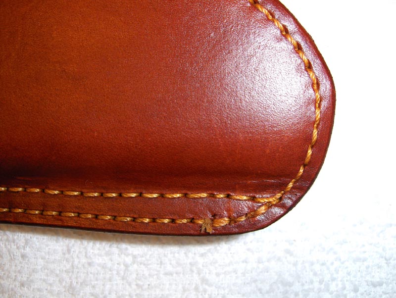

Yes, . . . it is. In addition to a different style, . . . this also was THE first holster I tried using my vacuum system. Not knowing how to use it, . . . experimenting as I went, . . . I used a piece of .110 veggie tan shoulder (just barely 7 oz) and really laid the vacuum to it. The weapon came out "fairly easily", . . . and I hung it up to dry. About 24 hours later, . . . it didn't want to go down in the holster, . . . so I shoved it in. I honestly thought I was going to have to cut the front seam to get it out. BUT, . . . I wiggled and wiggled till I got it out. Long and short of the story, . . . the mag button is seriously protected by a little dimple formed in the vacuum process, . . . I cannot take my thumb and press it hard enough through the holster to get it to realease. Maybe just a curious anomaly, . . . but it works. May God bless, Dwight -
