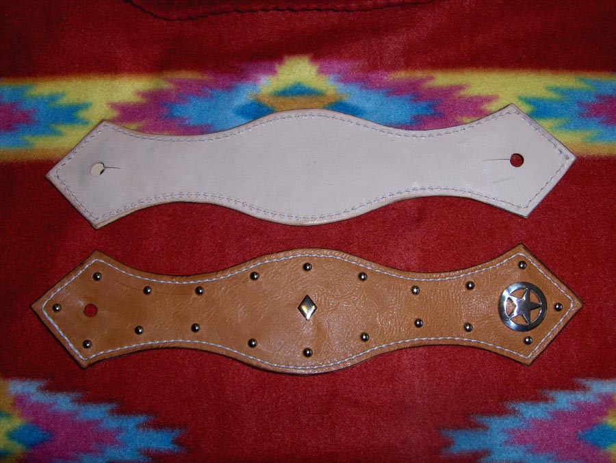

Reinforcing Band At Top Of Holster
Dwight replied to jforwel's topic in Gun Holsters, Rifle Slings and Knife Sheathes
You are over thinking this project. They are all sewn flat, . . . then dunked, . . . twisted, folded, bent, formed, . . . or whatever is needed. Don't think about it, . . . just sew it and do it. May God bless, Dwight -
