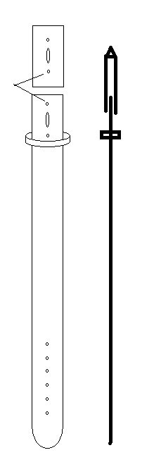

Just holler if you need a more detailed diagram. May God bless, Dwight -
